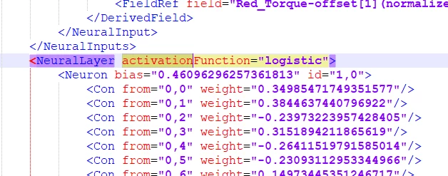

When checking the exported PMML file of a model trained with just 1 neural net learner, configured to use ReLU, I'm noticing that all activation functions (apart from the output) are declared as logistic.
How can this be? Maybe I'm interpreting the PMML file wrong, but I've checked the whole file and there's no mention of ReLU. I've done a lot tests and I'm not getting that parameter to change in the PMML file.

This is strange, at least for the internal nodes it should be visible. I suggest to create a ticket with support. And please post an update here.
