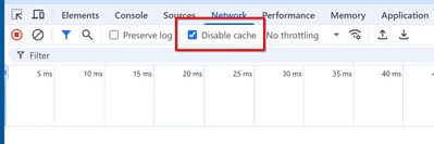

18-Opal
Aug 11, 2025 12:09 PM UTC
You should be able to bind from your Button's Clicked event to one of those two services in Mashub Builder, as usual, via drag-and-drop. If you don't see those two services in the list of Properties in mashup builder -- make sure you refreshed the browser after importing the extension. Also, ensure the browser caching is disabled while doing this (keep the DevTools open while refreshing):
