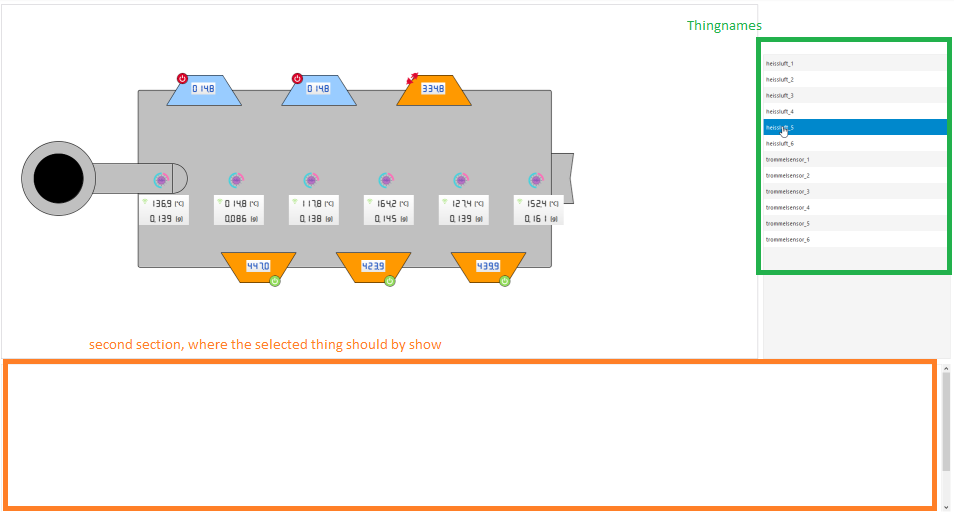

My idear:
I have a mashup which is slit into two sections.
Section #1 is a list with names of existing things (only strings). If I click on a name a mashup with this selected thing is show in section #2.
My problem:
Section #2 is a submashup. I give the selected name as input into the submashup. I wrote a service which should give me the thing by name. I try this with:
result = Things[Name];
and with
var params = {
    identifier: Name
result = Resources["EntityServices"].GetThingNameForIdentifier(params);
The first variant throw a "Invalid Reference to ThingWorx Entity" error message in the script log.
The second variant does not throw an error but its return undefinded.

I try to show what I mean with an image:
On the right side is a list of things. If I click of one of them the lower section have to change. The lower section is a submashup which have an input type of THINGNAME (which mean a thing). With the getThingByName I want that its return the thing of the selected thing name and put it in the input params of the second section.

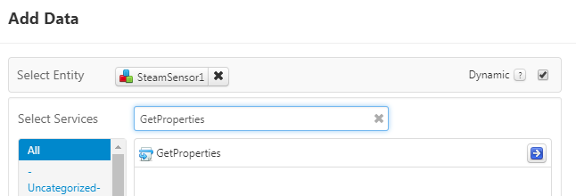

It looks like you want to dynamically pull the properties of the selected thing based on the selection?
If so, add the Thing as you would normally add data, but check the Dynamic button:
Then bind your Thing name to the EntityName parameter on the service:
Finally, trigger to run the service on the entity change event from your rmashup parameter.
Hope this helps!
