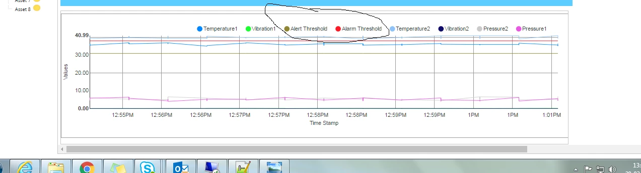

Dear Team,
How to show fixed line in time series chart as threshold without taking as DataField?
Currently I am showing Alert Threshold  and Alarm Threshold as DataField. But I don't want to show these two line as Data Field. From Stream, Alert Threshold and Alarm Threshold getting fixed value. Ex 38. These two line need to show as fixed line without Datafield. I don't want to show in radio button .

April 14, 2017
You can create a new property for that constant value and set the default value whatever you want. Make it persistent value.  It will be added to the stream with that value and then it can be displayed in charts. We used it to show upper and lower boundaries in the chart. I hope it helps.
April 17, 2017
Hi Bhuwaneshwar Gupta​,
As per my understanding this feature is not available. If we want to show some line in the TimeSeries chartt; we will have to take it as a DataField.
As a workaround; you can set the DataLabel Field for these field as a whitespace character. So, it will show just the color without any label.

April 17, 2017
Thanks Ankit. This workaround will work.
