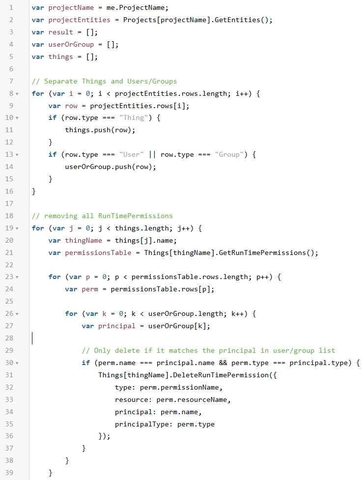

I use Thingworx version 9.6.2. It seems that the Resources["SecurityServices"].DeleteRunTimePermission first parameter type needs to be "Thing" for example if one is to remove permissions from that thing.
This is the code for a service to remove all permissions that i have to far, however the error message i get is following:
Error executing service RemoveAllPermissions. Message :: Invalid Permission Type : [Thing] - See Script Error Log for more details.
The point of the service is to remove all existing permissions added to a thing from a user or group, NOT changing the permissions level like read/write/subscribe etc.
Code:

Services "DeleteRunTimePermission" and "DeleteDesignTimePermission" are defined on all entities, and "type" parameter is for the permission type, not entity type.
If you want to simply remove everything from an individual Thing, the easiest would be like this:
for (var i = 0; i < projectEntities.rows.length; i++) {
 let row = projectEntities.rows[i];
 if (row.type === "Thing") {
 let thing = Things[row.name];
 thing.SetRunTimePermissionsAsJSON({ permissions: {} });
 thing.SetDesignTimePermissionsAsJSON({ permissions: {} });
 thing.SetVisibilityPermissionsAsJSON({ permissions: {} });
Just to make it clear -- there will be still some permissions, which those things inherit from their parent Thing Template and from Collection level. Also there's the Owner semantics, which you need to keep in mind. So if I may ask -- why do you want to do it? There might be another, better way to achieve what you need.

Jul 28, 2025 9:39 AM UTC
This code seemed to fix the problem:
The reason for this service is to get a form of "clean slate" when you can take in a project, clear all existing permissions of all things in the project so you can start fresh, if a situation like that would appear.
// PK

Jul 28, 2025 9:42 AM UTC
Did you try a snippet I provided? It is five times shorter, and also handles design-time and visibility permissions.
What you wrote there can be achieved with a oneliner:
Projects[projectName].GetEntities().rows.toArray().filter(row => row.type === 'Thing').forEach(r => Things[r.name].SetRunTimePermissionsAsJSON({ permissions: {} }));
