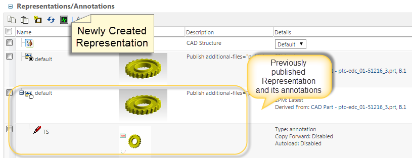

Line 1) - by forcing the republishing for existing default representations, or not
Line 2) - Note: The Publish_EPMDoc_WithCSVFile schedule method deletes the existing Representation (along with any Annotation Sets) before publishing a new Representation
What happens if I'm NOT forcing the republishing of existing default representations and using the publish_epmdoc_withcsvfile function?  I don't want to lose annotation sets on assemblies that are already published with a default representation.  Do I need to make sure assemlbies with a default representation are not inlcuded in the CSV file for this scenario?
This is YSH's response:
Publish_EPMDoc_WithCSVFile UI scheduler method only use wvs.jobs.publishFilter.withCSV parameter and do not get any other parameter value in additionalEPMDocJobs.properties. It is hard-corded in AdditionalEPMDocJobs.java source as below.

Publish_EPMDoc_WithCSVFile schedule method will delete the existing Representation (along with any Annotation Sets) before publishing a new Representation. It will remove previously published Representation and it’s annotation. Both Representation and it’s Annotation should be removed together.
If customer comments out below lines in AdditionalEPMDocJobs.java source (787 ~ 791 lines). Then, the Publish_EPMDoc_WithCSVFile schedule method will force republish the CAD model and will not remove previously created Representation and its annotation set. i.e. Customer will see 2 Representation in the CAD Document.
Comment out these line in AdditionalEPMDocJobs.java source (787 ~ 791 lines):
     try {
      deleteRepresentation(epm);
      } catch (WTException e) {
      throw e;
Force to republish Result: 2 Representations
