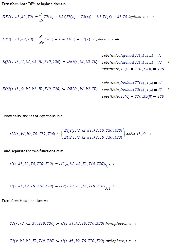

I want to add an iteration process to an ODEsolve block. It would require iterating an initial condition until two of the solutions match.

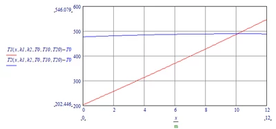

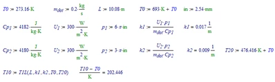

Answer: T1(0)=202.446 °C
Your problem:
Solve the set of ODE:
Extract the functions:
Check that it's the solution:
Solve the problem to find T10 for T1(L)=T2(L):
Fill in the numbers:
Plot:

See attached worksheet.  This worksheet has been simplified down to the basic equations.  Currently I am required to iterate variables until the solution of both equations is equal at "L" (T1(L)=T2(L).  All variables could potentially be iterated to achieve the solution, but most common would be T1(0) or U1.

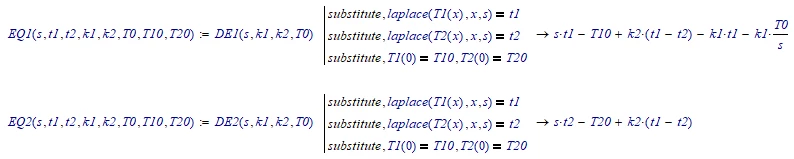

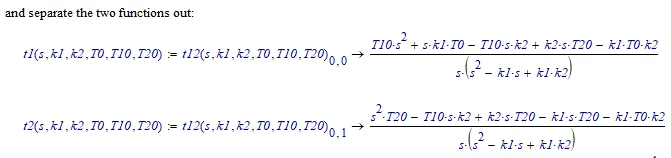

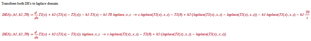

That is one way. As usual there are several ways (to Rome). So you can also do it the numeric way, by making the result of the solve-block a (set of) function(s) in T10, after which you can solve for the proper T10-value that makes T1(L)=T2(L).
You can also use the symbolics available in Prime 8 to compute the solution via the Laplace transform, which changes the set of ODE into a set of equations, which you solve and then transform back to the x-domain.
That goes like this:
Now with results
Note that in Prime the result may have the laplace integral (definition)
(  Something like LucMeekes_7-1758579389325.png   )
instead of "laplace(T1(x),x,s)" and "laplace(T2(x),x,s)" so you may have to change the substitution below for your needs.
Simplify:
The functions may become big, but they should still be workable.
