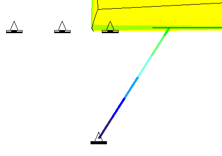

I have an assembly where I am modeling an anchor from a structure into concrete with a beam element and conducting a modal analysis. The end of the beam in the concrete is constraint in all 6 DOF and the other end is connected to the structure via a weighted link. The base of the structure is contratined to prevent vertical translation (y). The net result of all of this should be a fixed end-guided end beam condition (shown below).
http://www.codecogs.com/users/23287/Cantilever-Beams-018.png
However, when I look at a deformed plot of my model, it looks like the "fixed end" is allowing rotation. The beam is not going through a "S" shape deformation and it looks as if there is rotation on the fixed end. The constrains on the top is defined on the surface of shell elements.
I have comfirmed that there are not any beam releases defined.
Any thoughts?

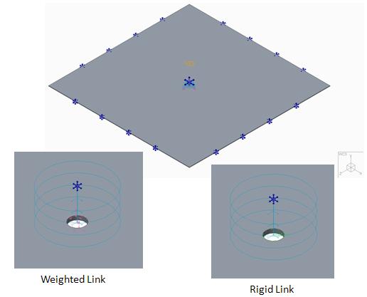

I know that the weighted link only gives TX, TY, and TZ control, but are you sure that it allows rotation? I only ask because I made a very basic model of a plate with a hole in the center and a beam element with one end co-planner with the top surface of the plate and the other end 1/2" above the plate. The beam end above the plate had 5 DOF locked and the 6th DOF set to a 3.14 rad perscribed rotation (about the beam's own axis). The outer edges of the plate were constrained as well (plate was modeled with shell elements). The co-planner end of the beam element was attached to the edge of the hole with a weighted link (in one analysis) and a rigid link in another analysis. Below is an image of the model setup.

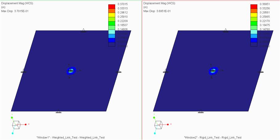

A contour plot of the displacement (magnitude) shows essentially the same values and contour.

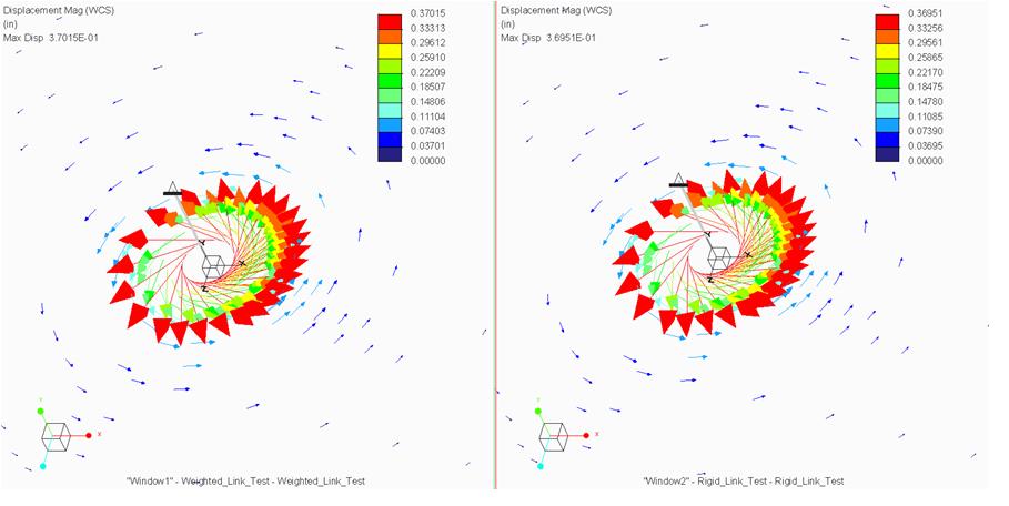

Looking at a vector plot of the results shows the rotation within the shell elements.
Getting back to the original problem I posted, if you look at the end of the beam with the 6 DOF constraint, it looks like the end of the beam is rotating. If it is true that a weighted link will allow rotations, then I'd of a fixed-end, guided-end beam setup, I would expect a fixed-end, guided-pinned.

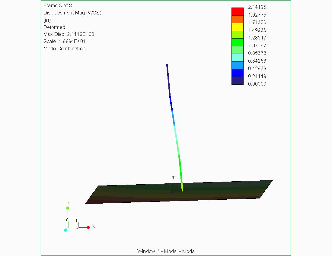

So, I performed you're first Modal simulation. I do get the S shape you were looking for...
So I'm not sure what the difference between our studies is...
