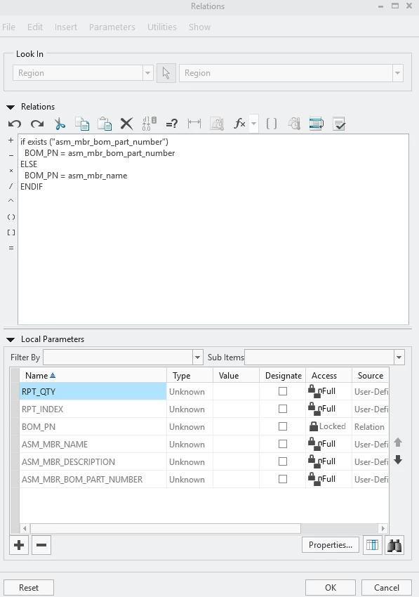

Having done some research, it looks like relations can be added to the repeat region, and so a conditional statement can be added. Descriptively, what I had in mind is that if the parameter ‘BOM_PART_NUMBER’ exists in the part, then this is used in the column. If it doesn’t exist, then the standard number as defined by asm.mbr.name is used.
Copilot suggested adding this relation:
IF EXISTS("BOM_PART_NUMBER")
  BOM_PN = BOM_PART_NUMBER
ELSE
  BOM_PN = asm.mbr.name
ENDIF
But this doesn’t work.

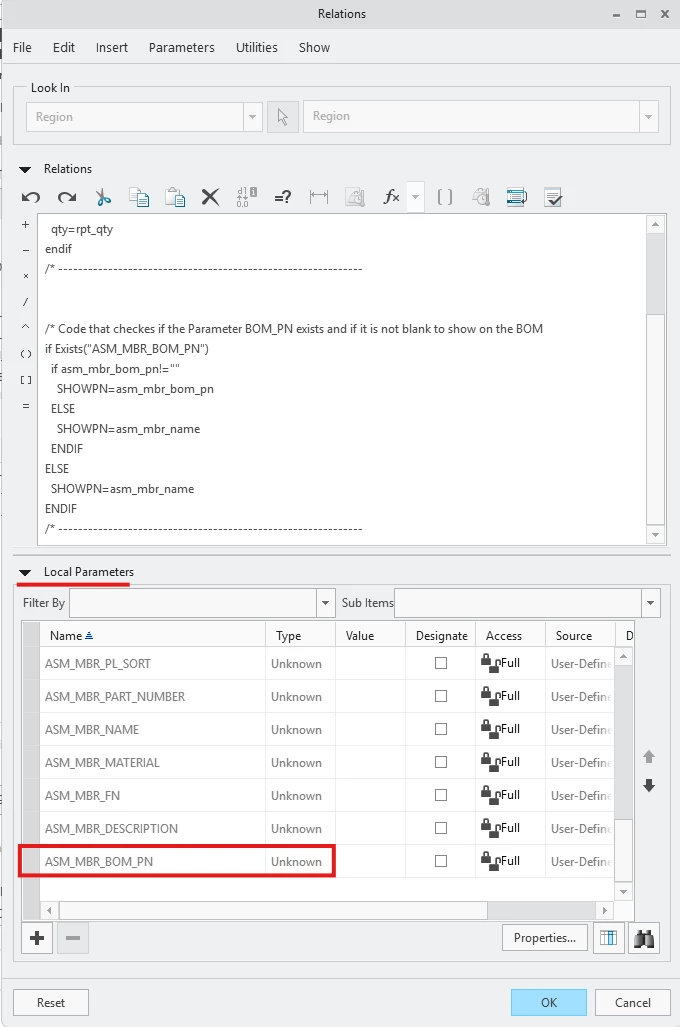

/* Code that checkes if the Parameter BOM_PN exists and if it is not blank to show on the BOM
if Exists("ASM_MBR_BOM_PN")
if asm_mbr_bom_pn!=""
SHOWPN=asm_mbr_bom_pn
ELSE
SHOWPN=asm_mbr_name
ENDIF
ELSE
SHOWPN=asm_mbr_name
ENDIF
Some things to note.
Just because you add the relations into the table will not make it work inherently. What I would recommend doing is also look at the Local parameters. See below.
If you do not see it I would add a column with the parameter you need the relation to see. Once you have verified that the relation works you can remove the column that only has your parameter.

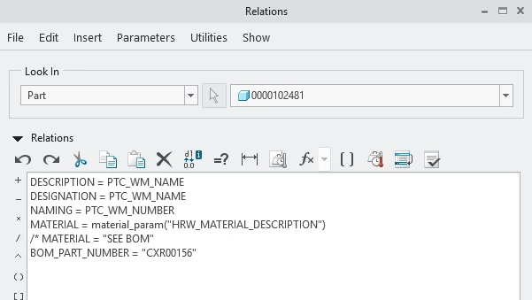

There was two gotcha’s that I’d missed that are required:
  1. The parameter in the part is ‘BOM_PART_NUMBER’, and so in the relations in the table, this needs to be preceded by ‘ASM_MBR_’ so that it becomes ‘ASM_MBR_BOM_PART_NUMBER’
  2. This parameter needs to be added in to the local parameters section
So, the part has this:
and the relations in the repeat region has this:
