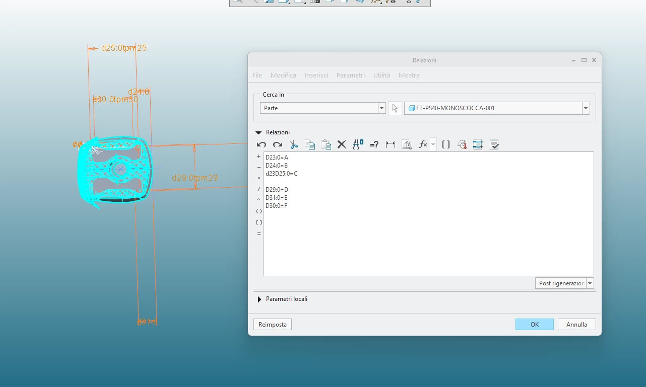

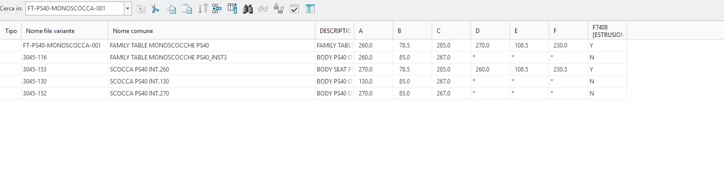

I created a PRT family table, where my variants are two features, which I named "A," "B," "C" (Feature 1) via "post-regeneration" relationships, and "D," "E," "F" (Feature 2).

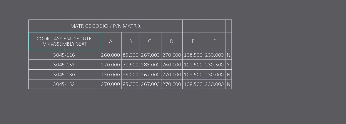

In some instances, feature 2 is suppressed, even though the "family table" displays "*" in the values ​​for feature 2, so "D," "E," "F." The table displayed in 2D inserts the generic values. (The 3D of the instance is correct, so feature 2 is suppressed.)

    An asterisk in the family table column for a particular instance means the values from the generic will be used. If the feature is not turned on, those values could be anything; they will not be used.

    So you have parameters that are used to assign the values of dimensions in the features of interest.
    Those parameters always exist in your model, even if the feature they are used for does not.
    Therefore, their values in a particular instance will be shown in your family table, the generic values if you have an asterisk in the column for that instance. Try setting the value for one of the instances without Feature 2 to a different value, like 1.23 and you'll see that value in the table.
    To get what you want you could use table relations as suggested by others, like @Dale_Rosema . Or a cruder way would be to add text parameters like txtD and txtE and either set them to text the same as the number you want to see, or "=" or whatever to show that for that instance E and D are not relevant.

    It creates the instances correctly, that is, feature 2 is not present, as can be seen in the Family table, in columns D and F an asterisk is shown, I don't understand why in the 2d table, it shows me the values ​​of the generic, even though feature 2 is not present in those instances

    The asterisk means the value of the generic is the value of the given feature.
    Are looking to have a N/A value in the column or something like that?
    If so, you could right a relationship such that if the last column is "N" then the value of the "D" & "F" are "N/A" or "-".
