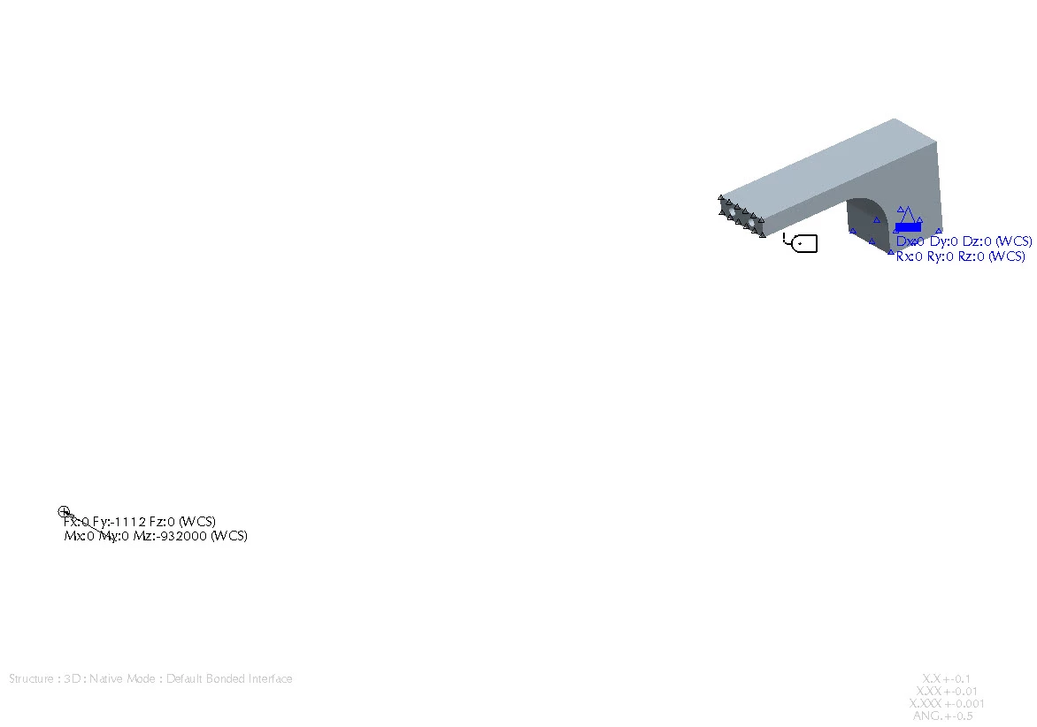

Good Day All,
Trying to apply a force & moment in mechanica to a surface on a part.
Do I have to apply this using Advance, Total Load, Uniform to get mechanica to apply the moment?
When I use a Simple Force/Moment Load mechanica ignors the Moment for some reason.
To close to the holiday and my brain needs a vacation.
Any help would be appreciated.

Donald,
You must use TLAP (Total Load At Point) to apply moments to solid models. This is because rotation degrees of freedom do not exist in solid elements.

June 30, 2011
So say the end surface of the part sees a force that is applied by another part.That loadload onthe other part is applied 33"away from the mating face and the load applied is 250lb.
Would it be applied to the part as I have done in the attached image and part file, wildfire 4. This is just a quick model for discussion.
Don Anderson
June 30, 2011
Rotation degrees of freedomdo not exist in solid elements .
I'm usingTLAP with just the force going forward.
I will have to play with the shelled suface technique some more.
I was hoping not to have to add any additional features to the model for applying the load.
It appears that either way I have to add something and think it will be easier on others to figure out if I use TLAP
(Total Load at Point) This way I just have to add one datum point to the model.
The moment inthe load I was usingwas not needed as you pointed out and cancelling my foce I was applying. (thanks Chris)
Thanks again for the help and have a great Fourth of July Weekend.
Don Anderson
