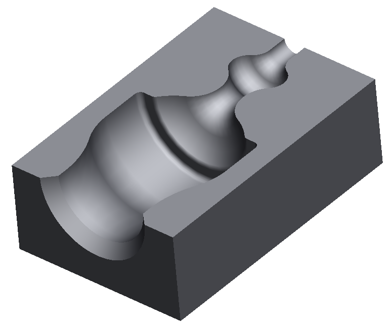

i'm a begginer in the use of CREO, so i would be grateful if you could help me step by step. I have a 3D model with a cavity; this cavity has a curved base surface very variable. In the cavity there are also some internal features at different heights. I have to get the negative of this cavity in order to calculate the volume.

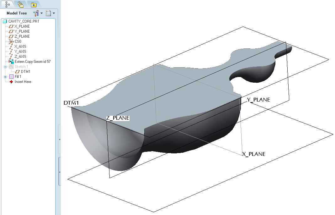

  • Create a new part. We'll call this the "core" model.

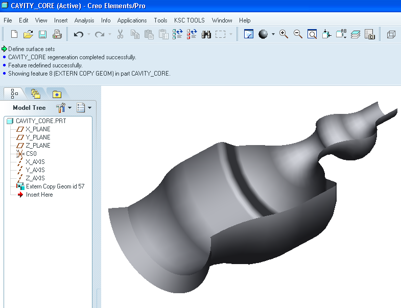

  • After the default datums, the first feature of your new model should be a Copy Geometry (External). Load in the cavity model at the default location. Copy all of the surfaces of your cavity bounding the area you wish to calculate. In my sample model below, I copied all the surfaces in red/pink. When this step is complete, you'll have a brand new model that only includes a copy of the pink surfaces- no other geometry.The image below shows the new core model with the external copy geometry feature... you can see the "core" surface, too.

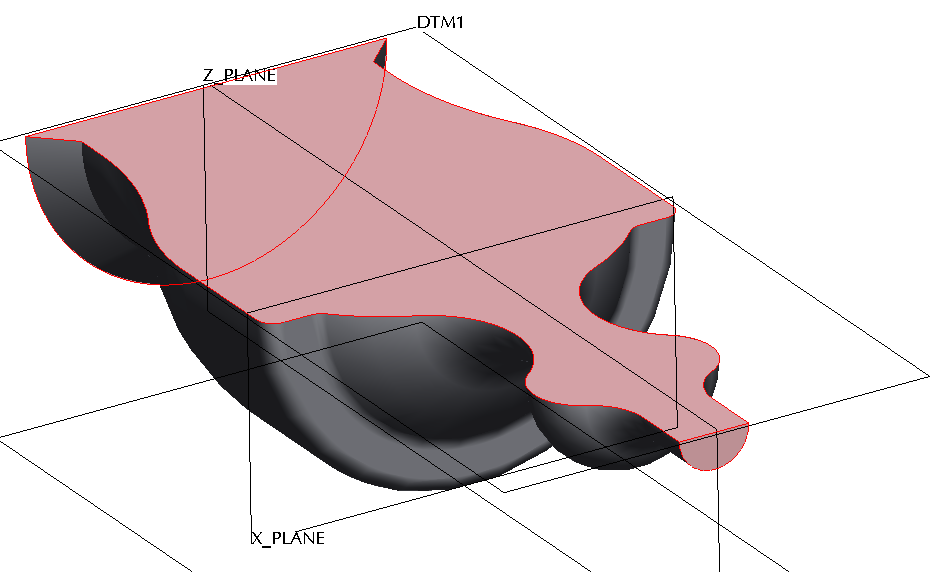

  • In the core model, close off the top of the open core using a Fill surface. Start by creating a sketch that follows the curves along the top open edge of your core. Make sure the sketch makes a completely closed loop. Complete the sketch. In the image below, I created the datum plane (DTM1) and sketched the boundary highlighted in red using the edges of the core as references.

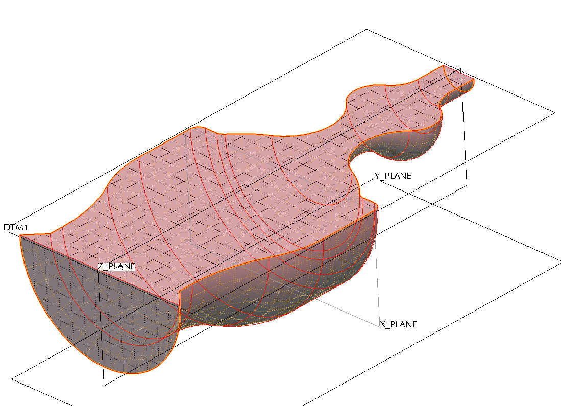

  • Select the sketch and then select Edit->Fill to create a filled flat surface from the sketched loop.The top surface will become closed off as shown below. Note the fill feature in the model tree.

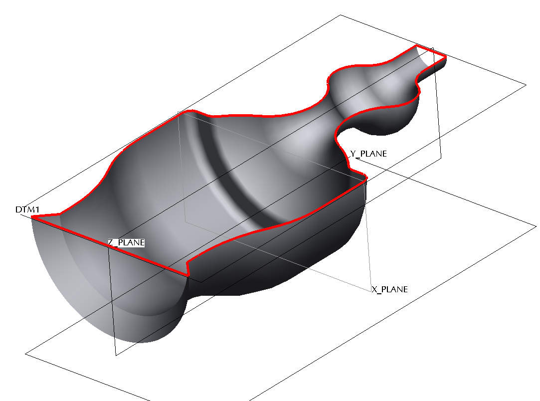

  • In the core model, generate two boundary blends (Insert->Boundary Blend) to "close off" the open ends of your model. You will need one for each end. You're attempting to create surfaces to "close in" the volume you wish to measure. In the image below, I started by selecting the edges along the open edge of the core (shown in red). Then I simply selected Insert->Boundary Blend and selected the green checkmark to complete the feature. No other options are necessary. Do the same for the other open end.

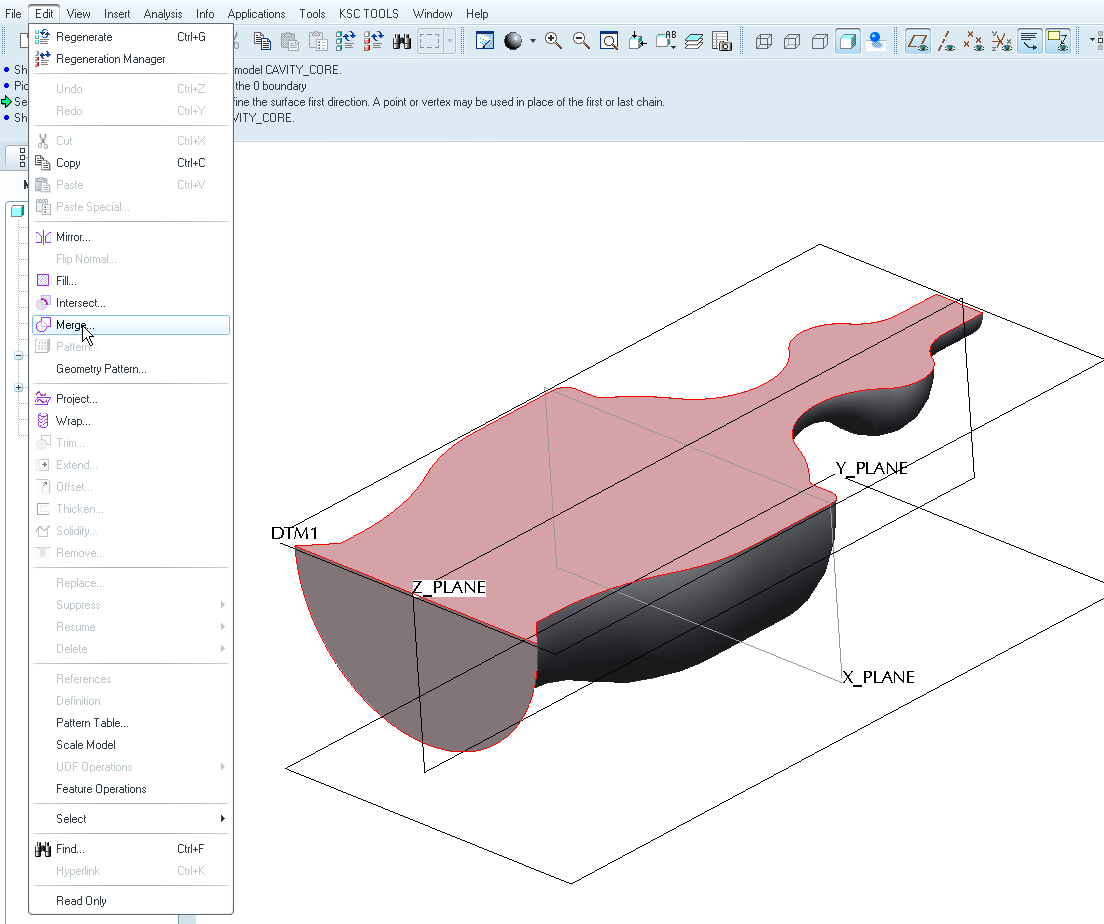

  • Merge all of the surfaces together (Edit->Merge). You'll have to merge them in one at a time. As you merge, you'll start to see the surfaces combining (you'll see a mesh-like grid across the combined surfaces that goes away once the feature is completed). In the image below, I started by selecting the two surfaces shown in pink... then selected Edit->Merge.

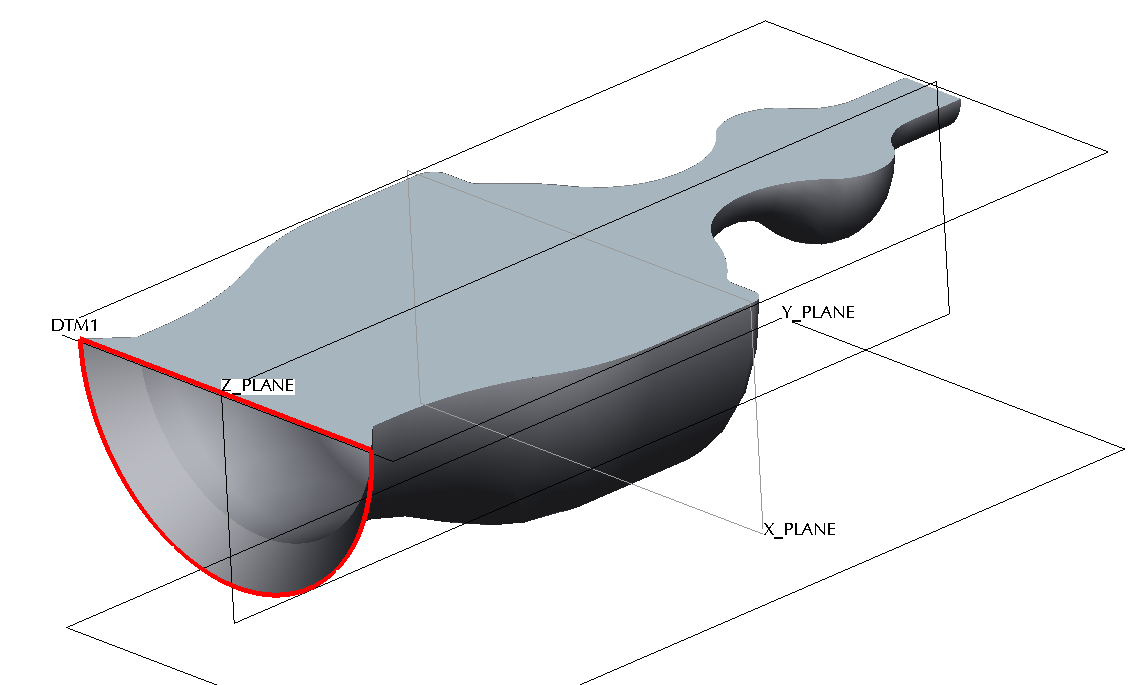

Next, I selected the surface on the other end... and the merged surface from the previous step...
Finally, I merged in the last surface (the complex bottom piece).

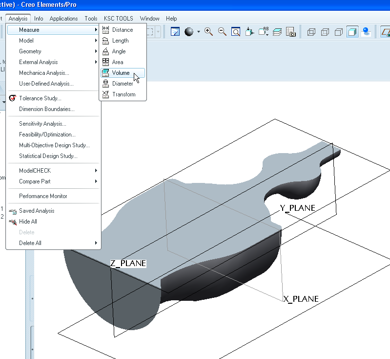

  • Once all surfaces are merged, select Edit->Solidify to create a solid volume.
  • Measure the solid volume using Analysis->Measure->Volume. As the original cavity changes, you can open and regenerate the core to see the volume update. If you add new curves or sections to your cavity, you may need to do some rework to the core model to insure those new curves are added to your model.

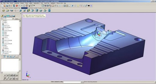

thanks for the answer. I need the negative of the cavity. Unfortunately the part is confidential so i can't post any pics. I found on the internet something similar.I have to get the negative of a cavity like this one.get_image.jpg
The part is imported from a PARASOLID file. It's recognised as a unique piece so i can't use the 2nd method. Regarding the 1st method you proposed, could you be just a bit more detailed on the various functions to use?
thank you very much!
