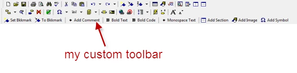

Thank you for your suggestions, they were very helpful. I loaded the xml file into the editor and the toolbar DID show up. I guess my problem actually is that it is NOT showing up when I open a specific type of document. In my case that's a docbook (actually docbook 4.5) document for editing. How do I get the toolbar to show in either of these two situations:
  • When the editor is first started and nothing is loaded into it
  • When I open a docbook document for editing.
Either one of these above cases would be good for me, but the first case (where the toolbar displays when I first start the editor) would be the most useful case for me.
I've attached a screenshot of the toolbar so you can see that it just sits in the UI with the other toolbars.

In that case, your script might be having trouble finding the XUI file. Your code only uses the filename, with no path info. You might need to be explicit with the location. The get_custom_dir() function can be helpful for this. Try modifying your editinit code along these lines:
#===> Load my custom toolbar on Windows.
  window_load_component_file(win, get_custom_dir() . "/editinit/my-custom-toolbar.xml")
  return win
Hopefully that will get it to find your toolbar. (FWIW, the return code of window_load_component_file() is just the opposite of what you thought; 0 means it was not able to load the document, 1 means success.)
Also, just as a tip, it is conventional to put XUI files into custom/dialogs, to keep it encapsulated from code in editinit or other custom dirs. If you move the XUI, of course you'll need to make the corresponding change in the code above.
