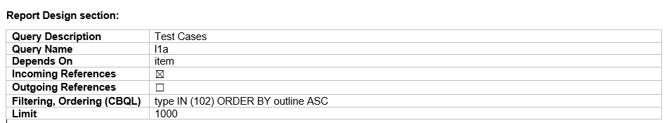

  2. Including the outline in the second query of the Word template
    • In the second query (for the linked Test Cases) I tried to include and sort by the outline field.
    • But the outline order still isn’t respected in the final joined result.

This behaviour is actually a known limitation in Codebeamer 3.2 Word exports.
When a Word template joins linked items (like Requirements → Test Cases), the export engine does not preserve the tracker outline order. Instead, the joined items are typically returned in internal ID order, which is why the sequence differs from the tracker hierarchy.
A couple of practical workarounds are usually used:
1. Sort explicitly in the template query
In the second query (the Test Case query), try sorting using the outline fields, for example:
ORDER BY tracker_outline ASC
or
ORDER BY outline_position ASC
Depending on the schema used in the report query. This sometimes restores the hierarchy order during rendering.
2. Use a stable sorting field
If outline sorting still does not apply after the join, the common workaround is to introduce a custom sequence field in the Test Case tracker and populate it with the intended order. Then use that field for sorting in the template query.
3. Alternative approach
Instead of relying on the join order, retrieve Test Cases through a separate query already sorted by outline and reference them from the template loop.
So short answer:
The export engine in 3.2 does not automatically respect the tracker outline during joins, and explicit sorting in the template query or a dedicated sequence field is usually required to control the order.
