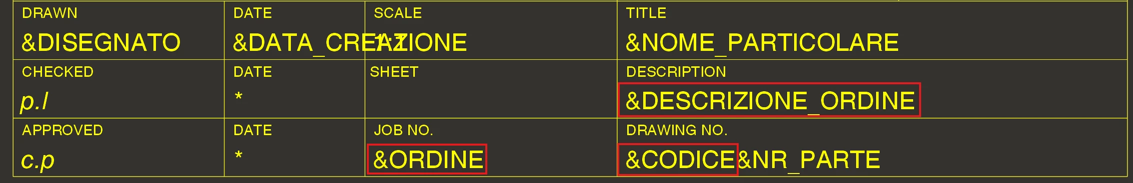

Good afternoon i'm using a creo parametric 11 version, i'm trying for my drawing to populate the "code nr." and some other parameter as shown below automatically.
For example a code can be "202500001_11" i want to manually apply che 202500001 code only on the main .asm parameter and use the same code also in all the .prt drawing on the repeat region.
Actually i write this code on the relation of all the .prt
DESCRIZIONE_ORDINE=DESCRIZIONE_ORDINE:1
NOME_PARTICOLARE=rel_model_name
DISEGNATO=DISEGNATO:1
ORDINE=ORDINE:1
CODICE=CODICE:1
DATA_CREAZIONE=DATA_CREAZIONE:1
QNT=QNT:1
And it works, but i cannot save this code in the start part of the .prt because of that ":1" that refer to the .asm and it does not exist in the new .prt.

Whenever I want to assign values or parameters to the components of an assembly, I do so by passing the values from the assembly, not by using assembly parameters in the part. The part does not have any stored information in it that designates the assembly it belongs to. In fact, a part could belong to multiple assemblies. The part doesn't "know" it is in an assembly. The session ID, the ":1" you are using, is assigned to the assembly based upon what order it was loaded into memory. ":1" is the first, the next will be assigned ":3", etc. Odd numbers for assemblies, even numbers for parts.
Putting relations in start parts that reference assembly session IDs is not going to work, unless you happen to have an assembly with that session ID in memory. But even then, it probably won't work like you hope it will.

as shown in the picture attached,in the drawing of every components i want to use, for the parameters highlighted in red, the same parameters used in the assembly.
It is possibile ?

I solve the problem with the help of both RPN and KenFarley.
Thank you everyone
