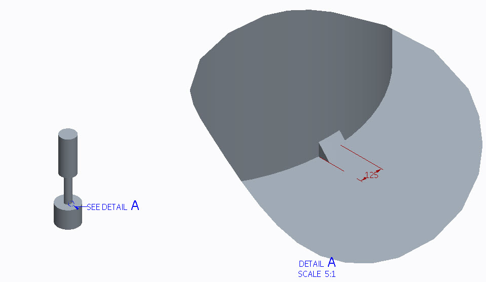

An example:
I have created a small feature on the model that I now want to add a new combination state to detail. In the days of 2D drawings I could add a detailed view with a center point selection (as shown).

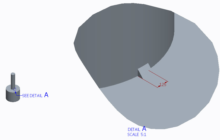

As the designed progressed, my 2D drawing detail view is still centered on the feature it details because of that center point selection. Like so...

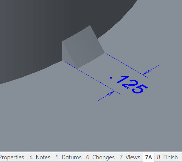

But in the new 3D world of MBD I start early in developing the MBD design and develop the following...

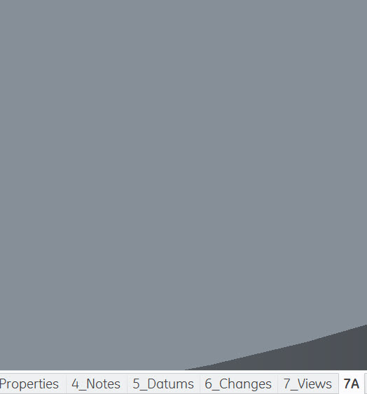

I end up with the following after the bounding box changes in my Combination View... The model has a new panned location so the details that I am trying to show are now off the screen! I have no "select center point for existing view" as I do in the 2D world.
Are companies instructing their users to build the entire model THEN annotate (meaning option 1 above) or have they determined some other option? I have tried both <AS IS> Orientation and a using a Saved View name that has both a zoom / pan state and orientation with the same poor results. If you just use the default views such as Standard Orientation and TOP / LEFT (others) from your templates your fine; as the models bounding box changes the Combination Views will update. Only views in which have tried to change the default zoom (non-Refit size) and pan to show the details do you run into problems.
