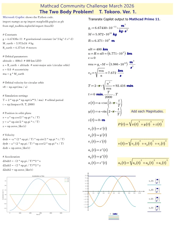

Mar 18, 2026 2:44 PM UTC
Ok. I guess somebody has to start, so here's an Express version of the first part.
ttokoro
Mar 21, 2026 10:06 AM UTC
Microsoft Copilot returns the Python code. Transtrate it to Mathcad Prime 11 and get the same results.
t.t.

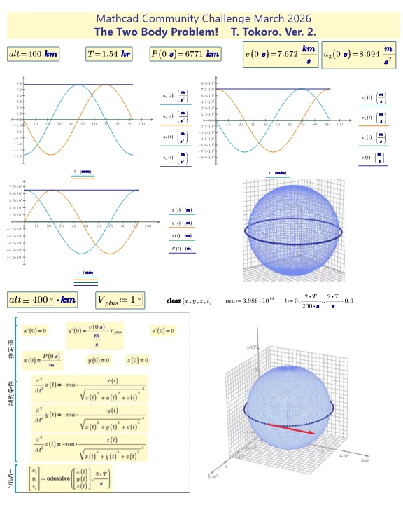

Mar 22, 2026 4:26 AM UTC
Ver. 2 can change the altitude, alt, of the MZD satellite in orbit and the Velocity booster factor, Vplus, of orbit.
3D graph also shows the v(0) by red arrow.
t.t.

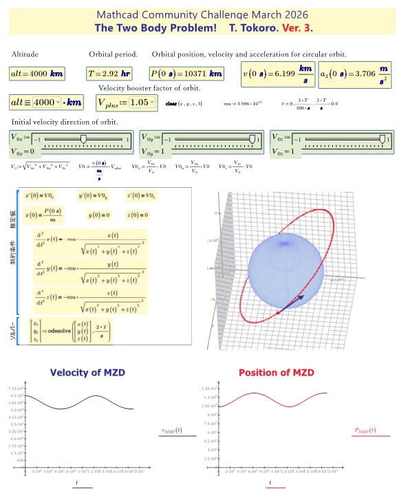

Mar 22, 2026 4:44 AM UTC
Ver. 3 can change the Initial velocity direction of orbit.
t.t.

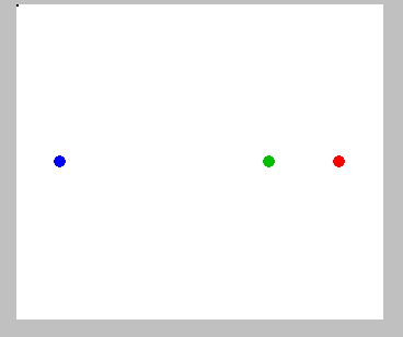

Apr 14, 2026 2:42 PM UTC
I wanted to provide a little input to this month’s challenge, so that there would be something on the special cases for the Three Body Challenge. I haven’t figured out how to use Mathcad’s Runge-Kutta to plot the orbits of three bodies. So I took the easy path of calculating the Lagrange positions for the Earth and Sun (easy stuff for Mathcad) as well as using some sliders so people can see the effect of playing with mass and distance.
