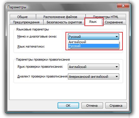

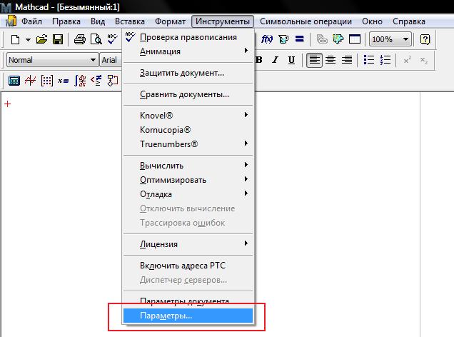

P.S. Anyway, here is how looks change of language from Russian on English in Russian version Mathcad 15:
MarkLaris1-VisitorAuthor
June 10, 2011
That's a little discouraging as I paid more for this version of MathCAD 15 than I did for the licensed copy on my desktop, but as the say "buyer beware". As for the solution, yes I was able to change the language as you suggested and when I open up MathCAD by clicking on the icon, it comes up in American English. However, when I double click on a MathCAD calculation, it opens in Russian. A solution to this problem is, however, moot as this is not a licensed (legal) version of MathCAD. Thanks for your help,
