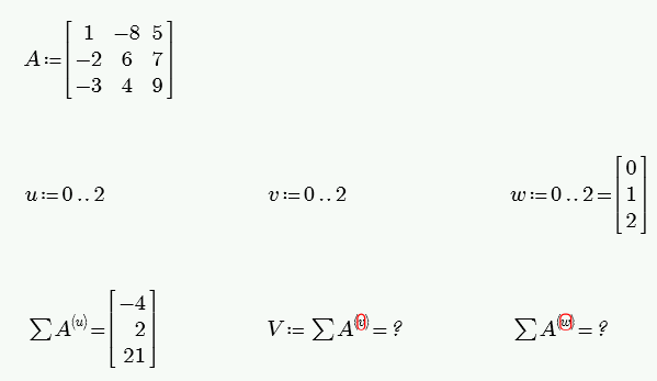

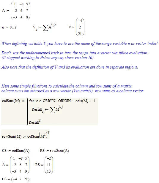

I just started using MathCAD Prime 3.0 and stumbled upon a problem. I can't find a solution to that online.
I have a question about this screenshot:
Why appending a result to a variable makes the operation impossible (1st and 2nd columns)?
Why showing the value of a variable makes the next operation impossible (1st and 3rd columns)?
Thank you. (I hope this post is in compliance with the policy)

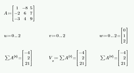

Have a look below at two alternatives.
The summation operator is implicitly looping through the columns of A. When the summation operator is assigned to a variable to have to explicitly tell Mathcad to loop through the columns.

Bilel,

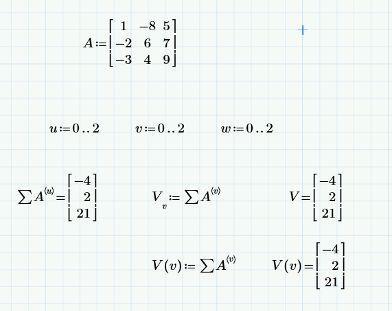

In your second column, you need to add a matrix index "v" to your variable "V".
In your third column, I'm not sure what the problem is.  Perhaps you have an incorrect label assigned to "w".  Or perhaps there's something different between your version of Prime and mine (Prime 1.0 on this computer).

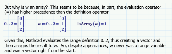

I've attached a worksheet that hopefully should give you a little more insight into what's going on, but I'll highlight a bit of it here:
Critical point to note: Range Variables are not Vectors!
Ranges and vectors are different data types, as are strings, functions and arrays, and each has it own set of rules.
u and v are range variables; that is, they both hold a range data type that specifies a set of values that Mathcad should generate when it has to evaluate u and v.  Think of a range variable as an implied for loop range rather than as a set of actual values. The actual values implied by a range variable don't exist until Mathcad evaluates the range variable and they only exist one at at time during the evaluation.
On the other hand, w (for reasons explained in the worksheet) is a vector.  That is, each of its values exists in memory; there is nothing "implied" about the values!
In your first expression, Mathcad evaluates the sum by generating each value of u (0,1 & 2) in turn, evaluating the sum of the corresponding column and then creates a vector from the individual elements.  It does not, as it might appear to do, evaluate the whole of the left hand side to create a vector and then display the vector result.  You can see this more clearly if you make the sum the argument to the IsArray or IsScalar function.
The second expression raises an error because, if you're going to use a range variable to do assignment, it must occur on the left hand side (lhs) of the definition operator, otherwise Mathcad will not evaluate the range variable.  As you don't have u on the lhs of the definition, Mathcad tries to get column u and fails because the column operator needs an integer argument and u's data type is a range not an integer.  So you get an error.  On the other hand, if you make u an index of V on the lhs, Mathcad will happily iterate over the range, producing 0, 1 and 2 in turn, all of which are valid arguments for the column operator.
The third expression doesn't work because w isn't, despite appearances, a range variable.  It is a vector (or, rather, it holds a vector).  The reason for this is subtle.  It appears as though the evaluation operator (=) gets evaluated before the definition operator (:=).  Consequently, Mathcad evaluates "0..2 =" to produce the vector [0 1 2] (see explanation for first expression). It then assigns this vector to w.
This means that the argument to the column operator is a vector,not an integer, so Mathcad raises an error.

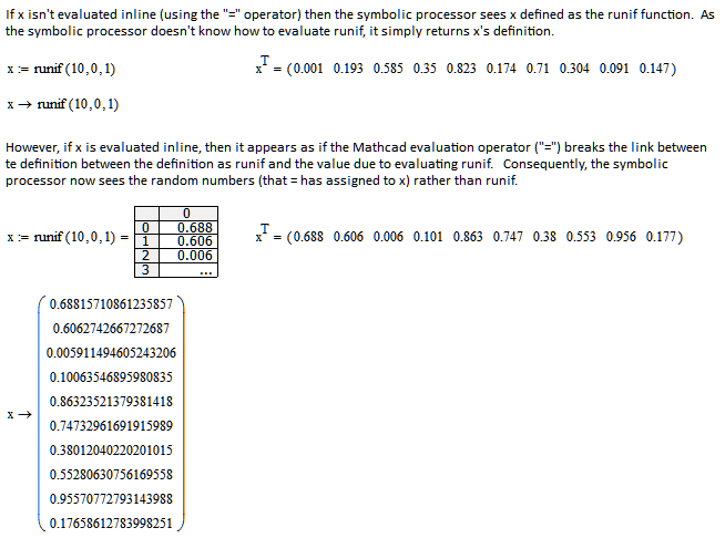

Thanks, Mike.   I first thought this when looking at what happens when you apply the symbolic processor to something that's had inline evaluation done.

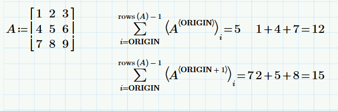

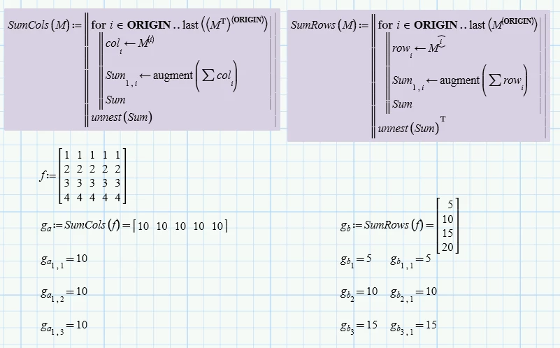

Here are some summation functions I made that returns a vector with the summation values for each of the rows and columns of any matrix.

Well then, now that this 10-year-old thread has been exhumed, and even though the original poster is unlikely to be interested in it after all this time, here are my comments on the matter.
What the original poster was trying to do will work if he specifies the range variable as a vector index when defining vector V.

May 22, 2026 8:05 PM UTC
Nice.
Test your functions also with ORIGIN set to 0.
