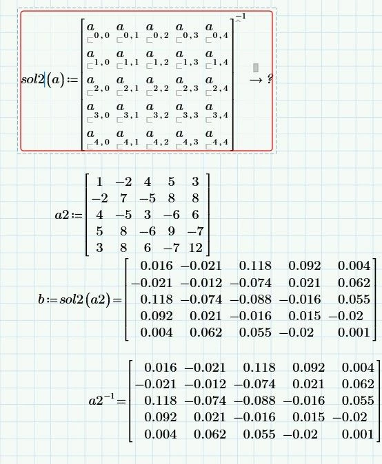

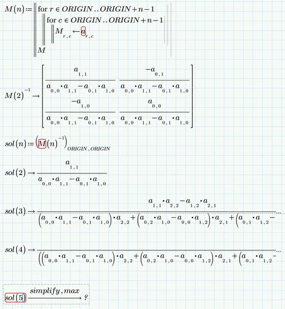

I think that I reached the full capability of Mathcad Prime 8 regarding the symbolic calculation. Or I am wrong?
Can somebody run this sol2 determinant in Mathcad Prime 9 to see the result?
Mathcad Prime 8 file attached.

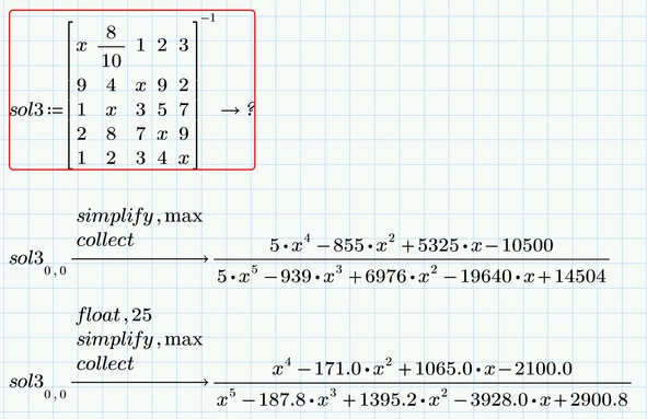

Here is what I see in Prime 9 when I recalculate your sheet.
As you can see the result for the determinant is much nicer, the one for the inverse seems to be as ugly than what you got in P8.
Using 0.8 forces the symbolics in some sort of numeric/floating point mode (unfortunately).
If possible its always worth a try to change float numbers to fractions with integers.
You may use the "float" modifier yourself if appropriate
Experimenting with the number of significant digits in "float" can give unexpected results
Not sure where the factors 1.0 stem from. Most of them go away if we omit the "collect" modifier - strange!

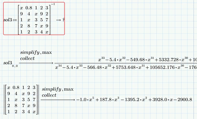

Apr 10, 2023 11:10 AM UTC

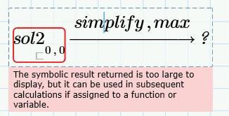

Very same effect in Prime 9, too.
Prime allows to display the numerator of the first element, but the denominator is too large in the opinion of Prime.
Actually its not a limitation of the symbolics itself as you get a result which you could assign a function (with 25 arguments) which then could be used for further calculations.
Its just an artificial display limitation as the developers thought that it would not make much sense to see an expression that huge and decided to save the memory which would otherwise needed for displaying the result.

@Cornel wrote:
I am wondering: what is the possible solutions to this thing? Some workarounds exist?
For me its not a problem which needs a solution.
If its a problem for you, you may contact PTC support and open a support case. Tell them why its a problem and talk them into modifying Prime so that larger results could be displayed  on screen (maybe like it could be done in Mathcad 11 by using a registry entry).
As I see it you have four options
  1. Wait for Prime to be modified accordingly (I won't hold my breath)
  2. Get somehow access to an older version of Mathcad (version 11) and use it
  3. Use a different program with more capable symbolic and display options (not sure if Maple, Mathematica, MatLab, ... could fulfill your needs)
  4. Think about what the benefit of seeing such huge expressions displayed on screen actually would be and maybe come to the conclusion, that its not worth bothering anyway ;-).

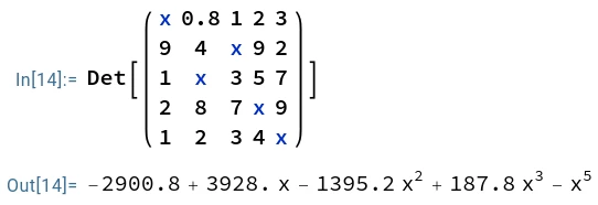

Yes, I know that, but here the problem is how to calculate symbolically the DETERMINANT and INVERSE of the matrix, not how to calculate numerically the DETERMINANT and numerically INVERSE of a matrix.

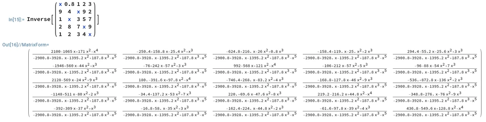

For example, look:
Result of the determinat with Wolfram Mathematica:
Result of the inverse of that matrix with Wolfram Mathematica:
Do you see the differences? The results of the two (determinant and inverse of matrix) from the two software are not displayed the same.
My question here: is it possible to see also in Mathcad Prime the same results of the determinant and inverse as it is shown in Wolfram Mathematica?
These results in Mathcad Prime with those great powers in calculation of the determinant (x^17 at numerator and x^12 at denominator) and inverse of matrix (x^33 at numerator and x^34 at denominator) seems strange...and I do not know why it looks like this and why Mathcad Prime gives the results in this manner.
