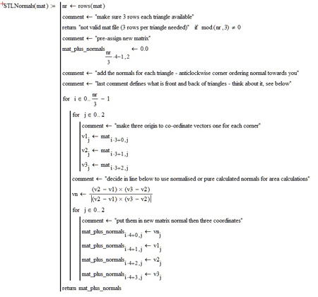

January 4, 2014

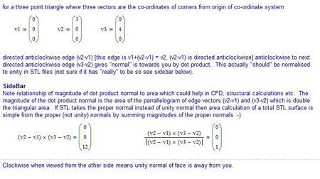

Function can be improved by adding the normals to the triangles making up the STL surface.  It only uses 0,0,0.
Surface normals are used by software that uses STL files to determine which is the front and back orientation.  They can also be used with a trick to help calculate the area of a triangulated STL surface.
Here is adjusted cpp file.  Input is a matrix with now four instead of three rows per triangle.  First row is normal of face, followed by original three rows of coordinates of corners.
MathCad can calculate these normals and adjust the matrix before submission to the writeSTL function.

Can provide the MathCad14 file with the small program that adds the normals but no idea how to upload a MathCad file only images of limited size and videos can be added in this web page.
