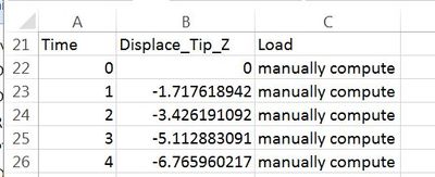

1.   Have 1:1 slope for time vs load applied.  Just the label is incorrect.  Change the label.
2.   Save-as the graph "deflection vs time" to Excel .xls (or .grt which is text file) and use spreadsheet (Like Excel) to convert time to load.  Compute or enter the load manually in spreadsheet.  XY chart in spreadsheet.

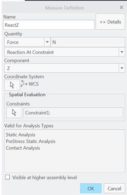

3.  In some cases the input force applied is found by the reaction force in the same direction at the constraint.  Since load vector = -1Z then Reaction Z.  This is a simple FEA.  Verify results are correct for other FEA problems.
