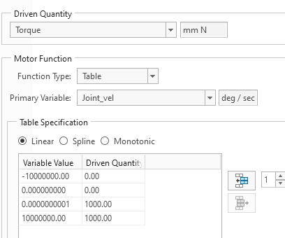

Here is how (two different ways) to put the conditional torque.  Be sure to include all the possible input range (I used -1E12 to 1E12 deg/s)
First way is user defined function. (key change primary variable from t to your measure)
Condition1Condition1
Condition2Condition2
Second way is by table. (key change primary variable from t to your measure)
