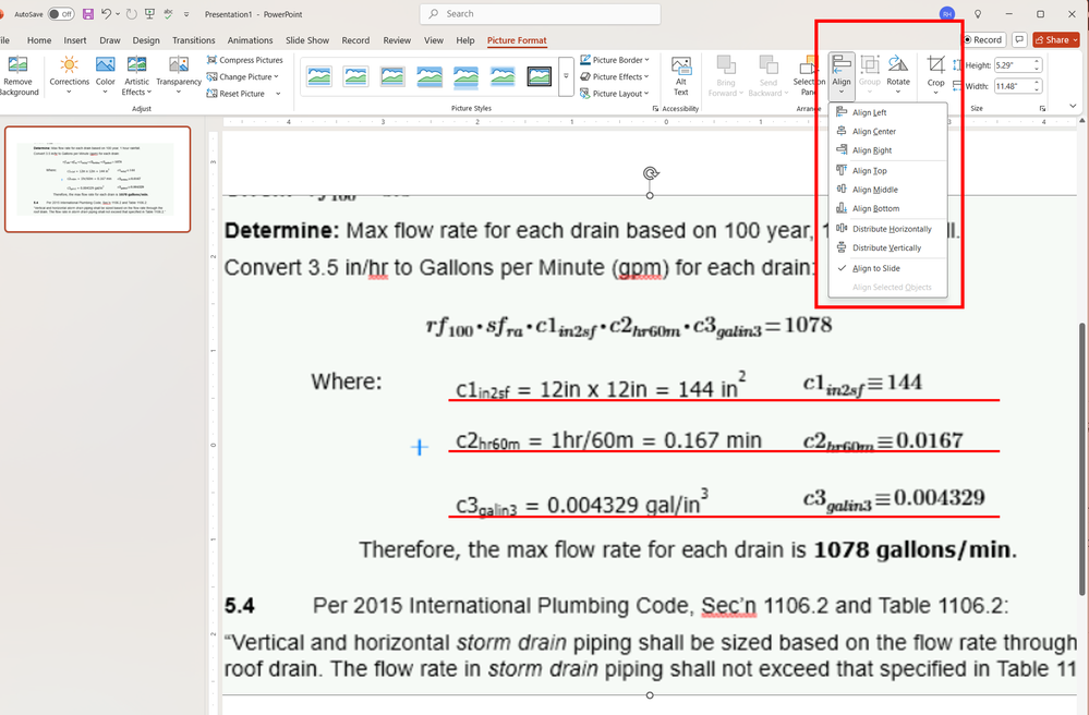

Is there a solution for this alignment problem. I have a customer who is extremely picky about how the reports look!!! Not only vertically as shown in jlee-10-11-12's picture above but also horizontally? I'm too used to PowerPoint I guess. Alignment help.png

No, PTC still provides no means to vertically or horizontally align regions. All that's provided is the regions snapping to the grid if you move them manually. So you are on your own.
