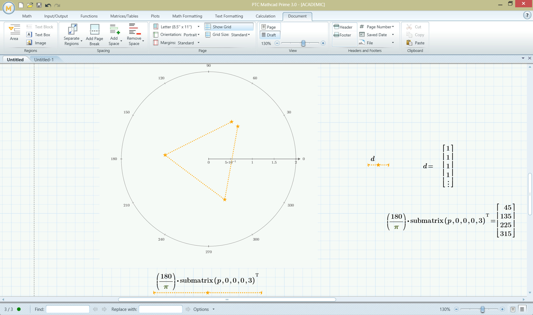

I have interesting results with a polar plot, where the plot obviously doesnt reflect the actual numbers. Any suggestions?
Any suggestions?
Yes! Post the sheet please, not just a pic.
Thanks, but have figured it out. Angular inputs are in radians, although there is not an option to display the polar plot in radians, only degrees.
Yes plotting is really mediocre in Prime in every respect.
You may consider using the degree sign (or write deg) rather than doing the multiplication 180°/pi manual.
Try do not multiplication 180°/pi manual
Yes, don't do it.
Converting units manually is an anatheme to all what MathCad stands for
