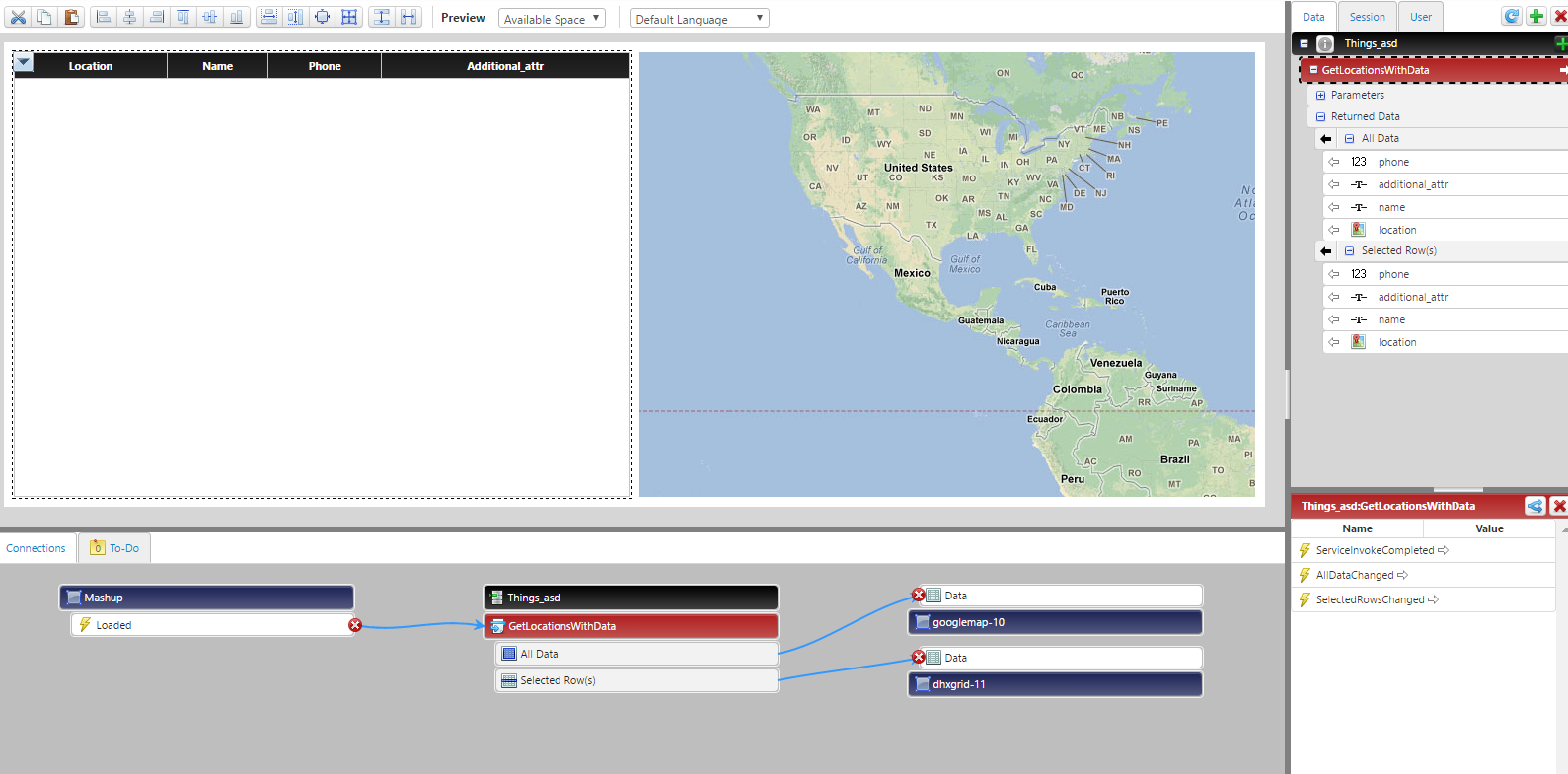

1. The easiest way.
​If your service that populates the Google Map returns also the additional attributes that should be shown when marker is selected, you can bind the SelectedRows of your service with the grid - this way, when you select the marker, a whole data regarding selected record will be passed to the grid:

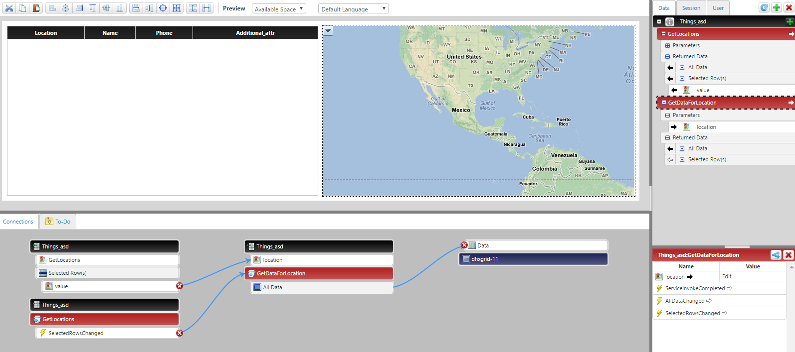

2. The more flexible way.
If you don't have the data as an result of the same service or don't want to use the previous way, you can pass the selected location parameter to additional service that returns more data:

Hi Jakub,
Yes it worked, I am able to display multiple locations but how to display the data associated with those locations in the infotable (i.e other fields in the infotable) on selecting any marker on the map.

jkaczynski
(To:psaxena)
Hi Priyanshi,
Above is my previous answer that shows how to do that using SelectedRow and another service. Have you tried it before?
Hi Jakub,
Yes I did try with the Selected Rows method but still its not working.
Moreover I don't want to display the details in the grid, rather I want it as tool tip in the map itself.
jkaczynski
(To:psaxena)
You're using GetPropertyValues OOTB service? In that case you can't do that, because this service doesn't have the DataShape on the output InfoTable. And if there's no DataShape on the result InfoTable, the Mashup Builder cannot "see" those fields. In your situation the best would be to create a custom service that would return all necessary properties as an InfoTable - but remember to create the DataShape with appropriate fields and set it as output InfoTable DataShape.
