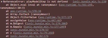

I've already tried to call the "playModelStep"-function (with params) from a filter, which I've added to a gauge.

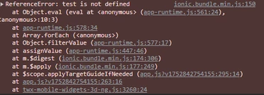

The function should be called, when the value matches the criteria, but when I look at the console (in Preview), it says that the function is undefined. I've tested it with another function and it works. Now, I don't know if it is because I tested it with a function that doesn't need any params or because it doesn't use any e.g. $scope.params.
Edit: It doesn't work anymore (idk why...)
I've also tried to call the "playModelStep"-function, with either a $scope.$watch(DataChange event) or a $scope.$on(DataChange event), but then I get this "message"...
here's my code:

Not sure, if this helps, but in the commented out section you are calling the function with "app".
$scope.app.playModelStep("Abbildung 1", "instructions_animation", 3, true);
I think you must use the call without "app":
$scope.playModelStep("Abbildung 1", "instructions_animation", 3, true);
