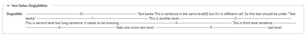

I'm experiencing an issue with the display of multiline text from a custom Data Utility after upgrading our Windchill environment from version 11.2 to 13.0.
I've developed a custom Data Utility which is used to display specific text information, retrieved from an attached Excel document, on the Attributes-Structure tab of WTParts( Thanks to @HelesicPetr  for idea 🙂 ).
This text data is structured to include multiple lines for readability (e.g., containing section headers and descriptions).
In Windchill 11.2, this Data Utility successfully displayed the text with proper line breaks, effectively creating a multiline output within the UI field/cell where the Data Utility is rendered.
However, after upgrading to Windchill 13.0, the exact same Data Utility code now displays all the text as a single continuous line. The intended line breaks are ignored, making the displayed information difficult to read and interpret.
Steps Taken (Troubleshooting):
  1. I confirmed that the Data Utility logic correctly reads the data from the Excel file and builds the output string with standard newline characters (\n) at the intended break points.
  2. Based on the observation that \n characters were not being interpreted as line breaks in 13.0, we modified the Data Utility code to explicitly replace the newline characters (\n) with HTML <br> tags before setting the value to the TextDisplayComponent.
  3. Upon viewing the modified Data Utility output in Windchill 13.0, we observed that the <br> tags themselves are displayed as literal text within the UI, rather than being interpreted as HTML line breaks. This indicates that the output of the TextDisplayComponent is being escaped and treated as plain text by the rendering mechanism in Windchill 13.0, despite our attempts to insert HTML.
Expected Behavior:
We expect the custom Data Utility to display the text with proper line breaks, as it did in Windchill 11.2, for improved readability.
Thank you for your time and assistance.

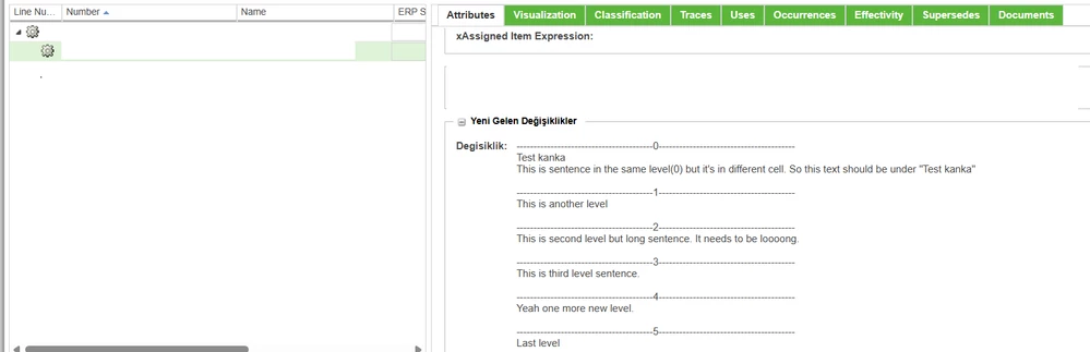

Hello @Anil_SAD
I've found a right component to use
very simple text with BR separator
results
 You just have to use RichText datautility and set a value
use extends com.ptc.core.components.factory.dataUtilities.RichTextDataUtility
and return a com.ptc.core.components.rendering.guicomponents.RichTextDisplayComponent
public class MyFunction extends RichTextDataUtility
	@Override
	public Object getDataValue(String componentId, Object datum, ModelContext mc) throws WTException
		Object retValue = super.getDataValue(componentId, datum, mc);
		if (retValue instanceof AttributeDisplayCompositeComponent)
			AttributeDisplayCompositeComponent dc = (AttributeDisplayCompositeComponent) retValue;
			RichTextDisplayComponent ricText = (RichTextDisplayComponent) dc.getValueDisplayComponent();
			String combinedValues = "text enter text </BR> system separator text </BR> text next row";
			if (combinedValues != null)
				ricText.setValue(combinedValues);
				return ricText;
		return null;
 PetrH
