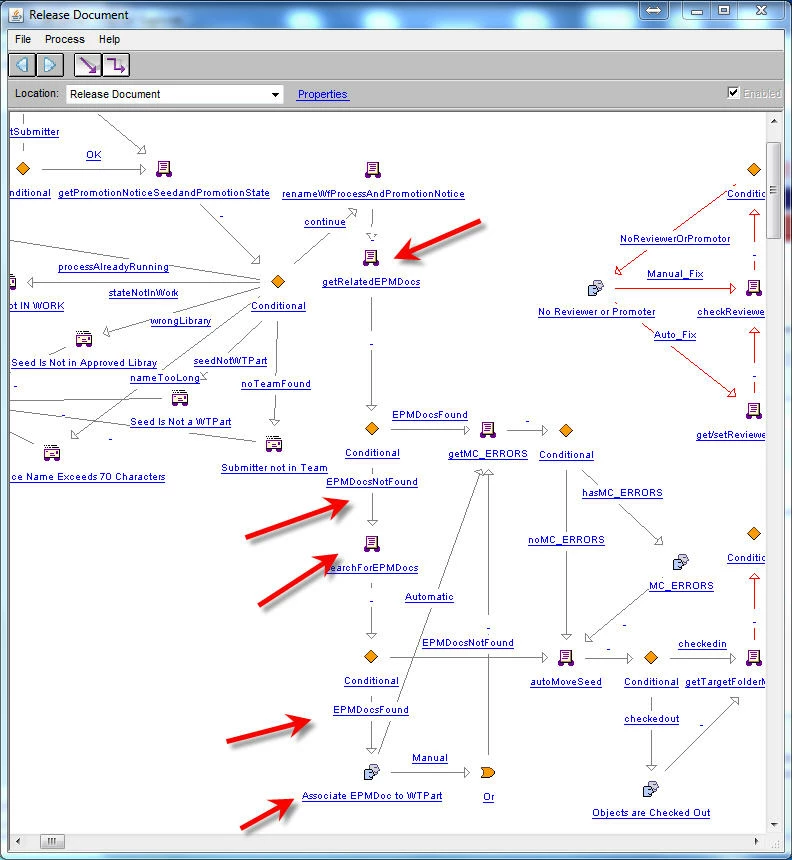

Steve,
I think we have all struggled with this. My conclusion is the only way to do this is to police it your workflow.
I wrote code for our workflow that first looks at the WTPart's related docs.
If it finds the correct number, revision EPMDocs are associated with th ecorrect link type (passive/active) all is fine and workflow keeps going.
If either model or drawing are not found the workflow searches the dB for them. If they don't exist the workflow keeps going.
If they do exist a task, Add EPMDOc to WTPart, is sent to the user point out their error.
This task has a default routing option of "Automatic" and accompaning transition code which will automatically associate the model (active link) and drawing (passive link) to the WTPart.
This linking could be done without sending the task to the user but if I did that they would never learn. This way the association is a no brainer for the user, they learn what is expected and dB is sound.
