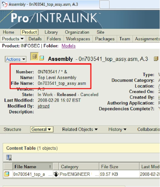

If you are referring to the ProE/WGM PTC_COMMON_NAME, in my past implementations, we have mapped it to the ERP material description and the PLM Windchill System Name. We also applied some customization to behave like an IBA. So you can change the NAME like a BOM, and the name has history. The workaround for using the save as history doesn't cut it. We just want the default Product Structure and EPMDocument Structure to behave like a normal BOM. I thought it was a more refined solution than having the ProE file+extension appearing for Windchill NUMBER, NAME and FILENAME. Use the attriubutes what they were hopefully architected for. To have the behavior of Pro/I X3 is just redundant.
