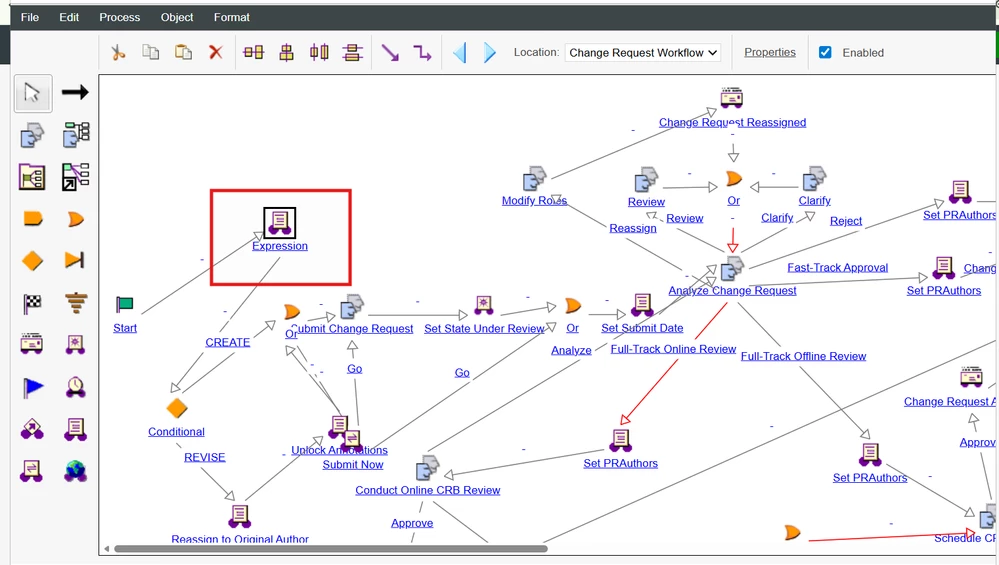

Need help with Code. Set Affected Objects on the CR from IN WORK to Under Review
Version: Windchill 12.1
Use Case: Creating a demo workflow to show users that Revised items can be set from IN WORK to UNDER REVIEW at the start of the Change Request workflow.
Description:
Help please.
Note a code guy.
Just need a workflow robot to change the state of the Affected Objects on the CR that are IN WORK to UNDER REVIEW.
We need the proposed changes to be locked so they cannot be edited while the Approval phase is happening on the CR.

Any reason you are changing states on the Change Request workflow? This is not standard practice to make state changes on items there. It should be further down the line in the Change Notice or Change task. There is example code in com.ptc.windchill.pdmlink.change.server.impl.WorkflowProcessHelper. That is where the OOTB workflow code is managed.
This is very old code but we used to see calls to methods like this: WorkflowProcessHelper.setChangeablesLCState((wt.change2.WTChangeOrder2)primaryBusinessObject,"UNDERREVIEW");
Normally the PBO was assumed to be a CN and it impacted resulting items, not affected items.

Thanks, it's been a while since I worked on a workflow so little out of my lane.
I just need (I think) a "Execute Expression" to be placed into the workflow so that I can drop that code you sent.
I may just have my audience just pretend the affected objects are set to Under Review and cannot be edited.

Before deploying @Fadel good suggestion, strongly suggest you talk with your clients about NOT changing states of items during the CR workflow. If you have a released object and you add it to this CR, it's state would be altered and it shouldn't. It should remain released. The future item (newly revised item) is what would be changing state and where changes would be seen. That should be done on the CN workflow to resulting items.

Use below code as pattern in a expression robot  ,it has been tested minimally and its only for wtparts  :
wt.change2.WTChangeRequest2 cr = (wt.change2.WTChangeRequest2)primaryBusinessObject;
try
wt.fc.QueryResult changeableObjectList = wt.change2.ChangeHelper2.service.getChangeables(cr ,false);
wt.change2.Changeable2 changeable2 = null;
while(changeableObjectList.hasMoreElements()) {
wt.fc.WTObject obj =(wt.fc.WTObject) changeableObjectList.nextElement();
wt.change2.RelevantRequestData2 relReqData2 = null;
if(obj instanceof wt.change2.RelevantRequestData2) {
relReqData2 = ( wt.change2.RelevantRequestData2)obj;
wt.change2.Changeable2 ca = relReqData2.getChangeable2();
wt.part.WTPart cap= (wt.part.WTPart) ca;
wt.part.WTPart part = (wt.part.WTPart) wt.lifecycle.LifeCycleHelper.service.setLifeCycleState(cap , wt.lifecycle.State.UNDERREVIEW);
part = (wt.part.WTPart) wt.fc.PersistenceHelper.manager.refresh(part);
catch( Exception wte )
wte.printStackTrace();
