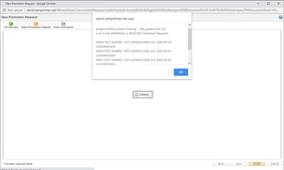

To prevent multiple promotion requests with the same promotable objects I always include an expression robot in the workflow (after the Start robot) that gets the objects on the promotion request and looks to see if an open (Not Approved or Rejected for example) request already exists. If a promotion request already exists do (whatever the require is). Maybe send email stating the situation, delete the new request and terminate the process, or send a Task to the creator explaining the situation. Really, whatever you want.
Another, and I think better, solution is to create a listener that listens for the addition of an object to a promotion request. The advantage of using a listener is you stop the action in its tracks and the user gets instantaneous feedback.
When the listener runs it checks if the object is already on an open request. If it is, throw an exception which opens a window to the user explaining the situation. Something like: “EPMDocument <number rev.iteration> is already on open Promotion Request <number name> and cannot be added to your Promotion Request.
The event I listen for is the PersistenceManagerEvent.POST_STORE of the "link" that links the object to the Promotion Request, not the Promotion Request itself. The advantage of using the post store event is that the object is in the dB but it has not yet been "committed" to the dB. Therefore, if something wrong, like the object is already on an open Promotion Request and an exception is thrown the commit to dB never happens
Here's a screenshot of the listener in action.
It prevents a user from creating a Promotion Request with an object that is already on an open Promotion Request. And it prevents a user from adding an object to an existing Promotion Request if the object is already on an open Promotion Request. The listener is really the way to go.
It provides instantaneous feedback to the user.
Works when creating a new Promotion Request
Works when adding to existing Promotion Request
It's bombproof!

Correct. One link at a time.
The reason I did it this way rather than keying off the Promotion Request is because if I key off the link my code works under all circumstances (making a new Promotion Request or adding to an existing Promotion Request).
It might be possible to key off the Promotion Request but I think you'd need to use a different event. Maybe the PersistenceManagerEvent.UPDATE event.
In the example I showed a drawing that was already on 5 Promotion Requests. I put the drawing an several Promotion Requests for testing purposes.
