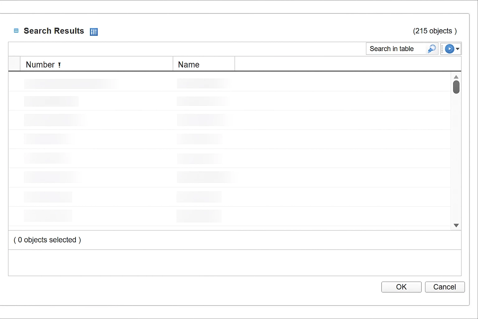

I have a created a picker for WTpart and also created a new view using jcaconfigurable table to show only name and number.
I am looking to change Number column to display as Similar Number,Is it possible to achive this?
Thank you

Do you have a screen shot of the UI?
May 8, 2026 5:40 PM UTC
Hi
Please see attached,I want to change Number to Similar Number

Hi ​@Srinivas_256 ,
Which method are you using to define the columns?
buildComponentConfig or getOOTBTableViews

Hi ​@TDT
I used OOTBTableviews,attached code for reference.Yesterday I noticed those APIs are deprecated,but there documentation is not updated though.Now I am looking for replaced APIS to get custom views along with column name change.
