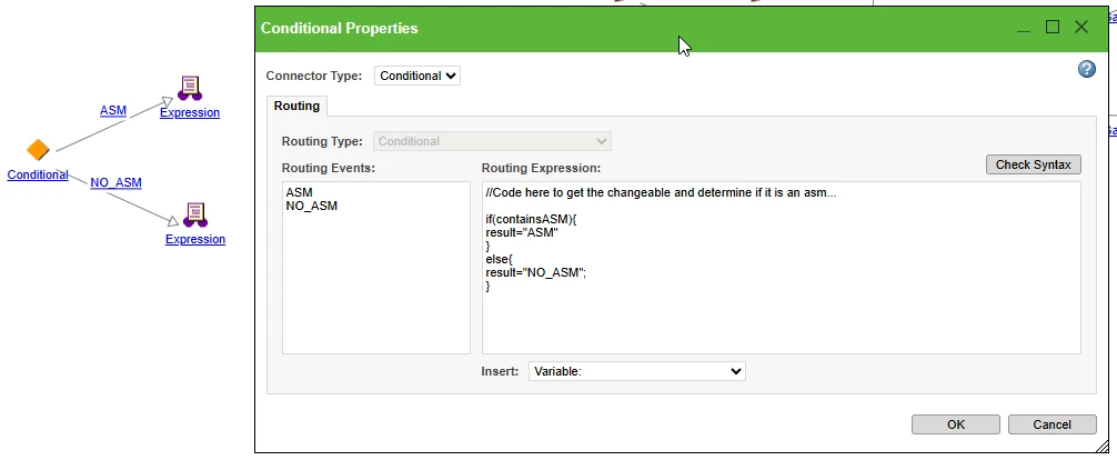

Workflow expression to check if asm files are included in a Change Notice
anyone could help determining how the workflow expression should be composed to get a conditional when a CN includes asm files in the affected objects.
Thank you.

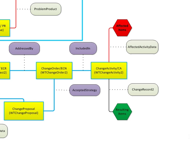

This case shows a nice visual of the links between change objects, and how you would get the “changeables” that are in the change.
https://www.ptc.com/en/support/article/CS63595
Look at the java doc for the ChangeHelper2 service. This will contain all the functions you would need to get the changeables, specifically if you’re looking for affected objects, getChangeablesBefore.
If you’re asking what the workflow would look like, it would be something like this….
6-Contributor
May 14, 2026 1:30 PM UTC
Thanks a lot for the reply :)
I was already half way there, having identified the wt.change2.ChangeHelper2.service.getChangeablesBefore and how to setup the required conditional properties.
What i can’t figure out is the java syntax that i can use to check the affected objects returned by the getChangeablesBefore and look for assembly files that might be included.
The following attempt,  returns “No EnumeratedType exists with "ASSEMBLY" as its internal value”. I am no Java expert, so this is a bit difficult for me to figure out how it works.
