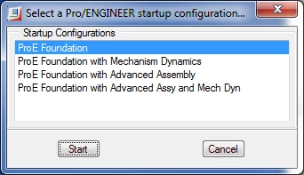

I don't know how many licenses you have or how many users but you may want to consider keeping 1 AAX in case the need arises (pro-program, external reference viewer, pub geoms etc) since they are floating licenses. We currently have 9 foundation seats, 1 seat of AAX and 1 seat of Mech Dynamics. We have them set up to prompt the user what version of license they wish when launching pro-e:
[cid:image001.png@01CD4238.BFF92370]
