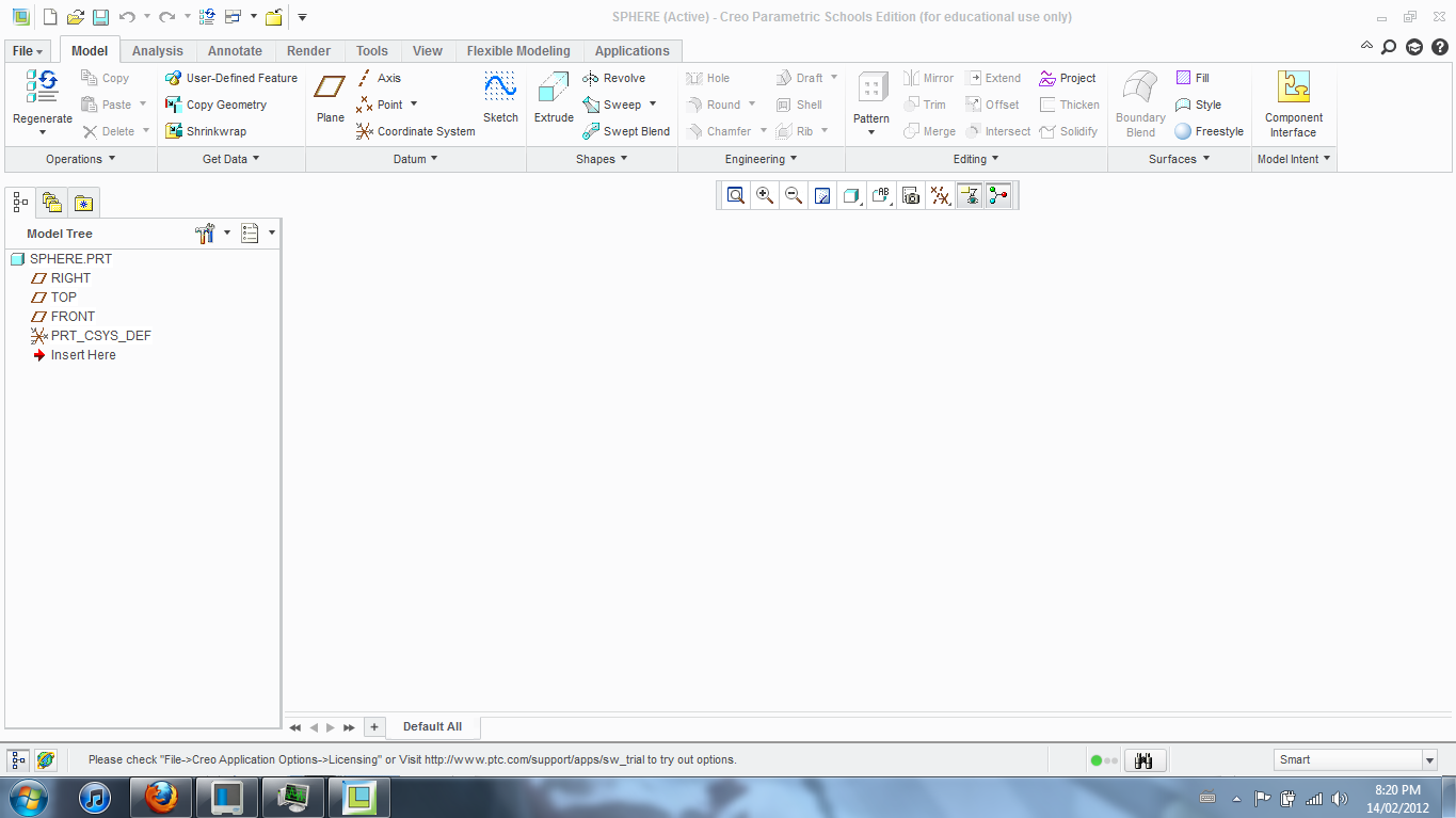

Whenever I start a new 'part', I get a blank screen with which I cannot do anything. The Front, Top, and Right planes are not shown. thus I cannot start any project or work. Here's the picture ...
Any idea?
Any help is greatly appreciated.
For your information, I have a school's edition of Creo Parametric.
Kevin.

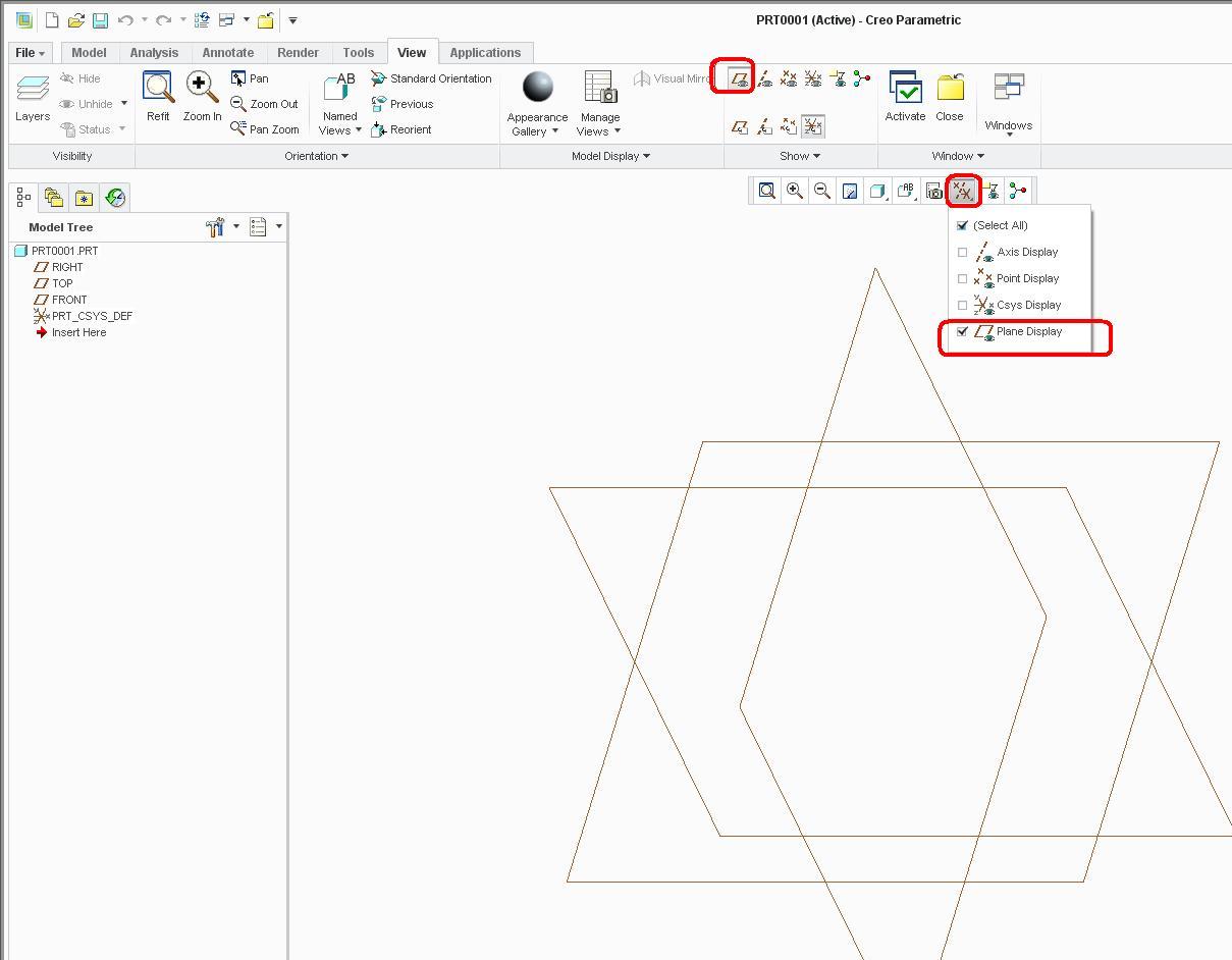

Hi
Check the following image
(If the datums are not visible at start you need to change some config setting)
Presetly you can active this with the following
Regards
K.Mahanta
KevinB1-VisitorAuthor
February 15, 2012
Thanks for the reply.
I checked that, but that it's already marked. Yet, the datums still do not show.
Any more ideas?
