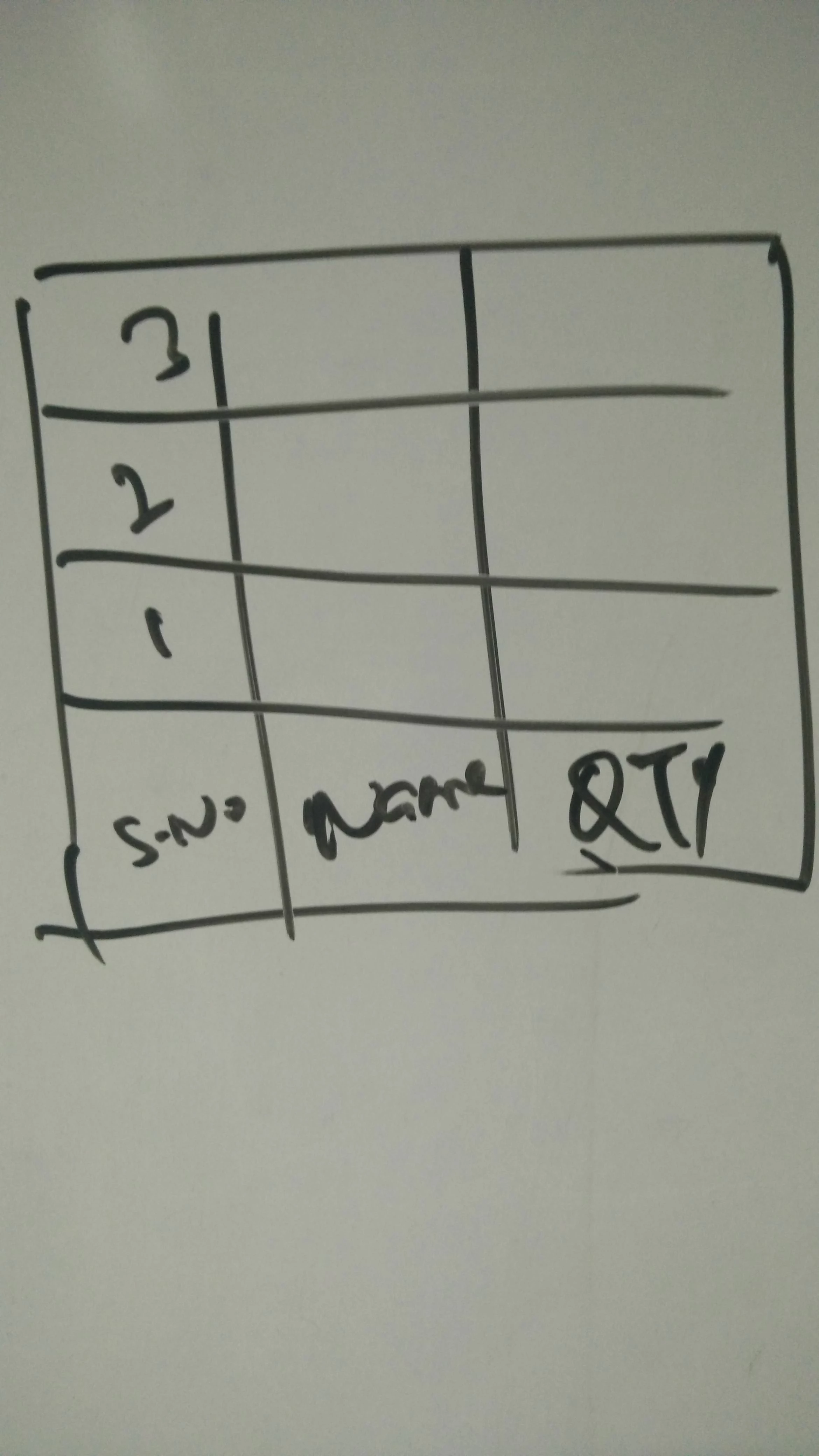

If I create the bom table it's starts with 1,2,3.. What I have to do if I want to Create bom from bottom to up??

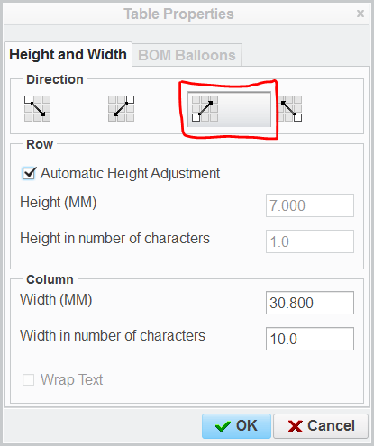

Elango,
you have to create table which growth direction is ascending.
