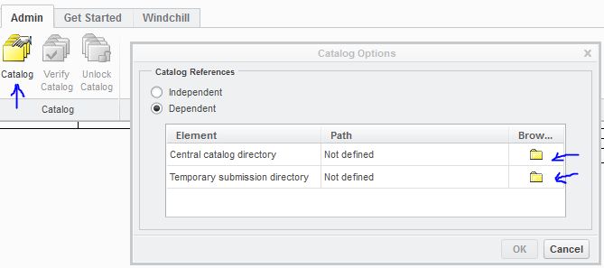

I know this thread is a little old but I just read it and wanted to comment. Jim's suggestion of virtual-interconnect seems to be the only viable provider for Creo compatible catalogs (cables, connectors and components). You may have learned by now that the prices are high. In my recent experience the items I use on a regular basis were not included in the package purchased by my company. Therefore I have been working on our own catalog. Now let me respond to the original question of how to set up a cable database. First of all, I think the term database is not correct and I feel PTC needs an enhancement to make the Creo Schematic catalog integrate with Windchill. Then it would be a database. For now, the Catalog can reside on any shared folder (preferably a secure server with controlled read write access). Set the location using the Admin>Catalog> select Dependent and browse folder for Central Catalog and Temporary submissions. New cables or connectors created in a design can be submitted to the temporary submissions folder from the Catalog Explorer. To reuse and share the new items, they can simply be cut and pasted to the appropriate folder in the Central Catalog using Windows Explorer.
Keep in mind, the selection of the Catalog References (Dependent location/Path) is only allowed in an open design. This is I feel is reason for another PTC enhancement to allow the Catalog References to be set as a global user option that would load or link when the application launches and not just design dependent.
