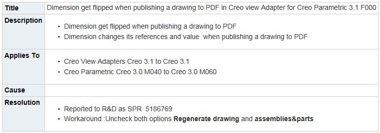

I just saw this come through from PTC.  Not sure if it's related to your case or not.
CS229017
afraser-21-VisitorAuthor
February 9, 2016
Thank you for pointing that out! Hmm... It certainly sounds like my issue, but it's on the wrong version of Creo.
We can try the resolution though and see what happens.

Well I feel silly, the CAD worker was running Creo 2.0 M060.
Our maintenance provider has been assuring us for months that we were on the same version, but after I finally got login credentials myself to check lo and behold it's on an older version.
Thank you both very  much for your help Tom Uminn‌ & Ben Loosli‌ for your time helping out!
