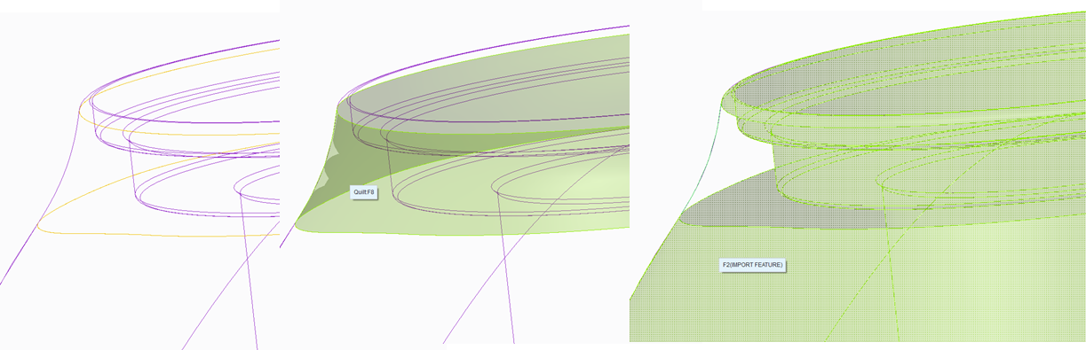

I'm normally found lurking in the Analysis & Simulation forum.
I have an import feature I need to mesh.
I have an import feature which comes in with a corrupted surface.
IDD sort of fixes the problem but makes a mess of many things in the process. It does mesh but the mesh is rubbish.
I deleted the corrupt surface but could not recreate it with the tools in IDD.
A style feature worked well.
Now I have a style feature that refuses to merge so I can 'solidify'
Perhaps I have approached this the wrong way?
I cannot upload the model but have included some screenshots.

Hi Charles, did you try collapsing the new quilt into the import feature?
then fix and solidify it in IDD

I shall give it a go ...
