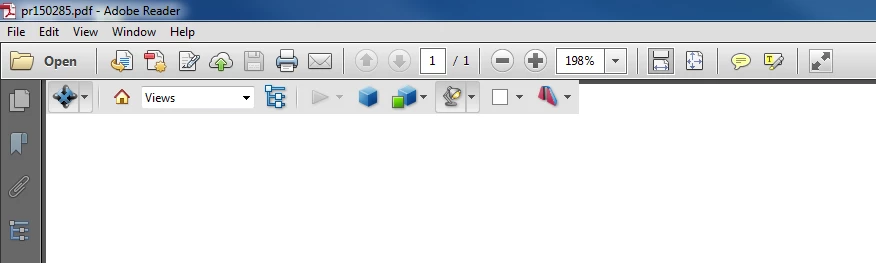

I do not see the camera/plus sign as described in the document. Is he using Adobe Reader to modify the file? If Adobe Acrobat is required, I won't be able to utilize this method.
March 13, 2015
I would guess that since it's a document editing function - those are in Acrobat. I think it requires Acrobat Professional. Buying guide | Adobe Acrobat XI Pro is a comparison table.
Adobe has a 1 month free trial for Acrobat Pro. See their website PDF creator, edit PDF | Adobe Acrobat XI subscription
