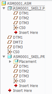

I don't know of a way to do it and preserve relationships between the skeleton and components.  However, here's one way I have used in the past to just do the conversion.
start:
create new skeleton by copy:
finished:
