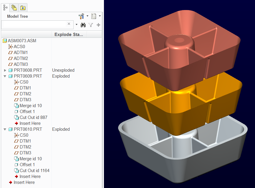

I am looking to create a part in Creo that represents a metallised plastic part. The base material is made from a plastic material and it has a very thin (10um) copper layer on top of the plastic with a final nickel layer (5um) on top of the copper.
Is there a way of applying these additional layers of material onto the surface of the existing part?
I intend to carry out some stress analysis on the part if I can achieve this build up of layers in the model.

It is always best to do something before trying to give advice on how to do it
I had the opportunity to try this and the results were good.
The best part of the attached assembly is that it remains parametric; the worst part of the attached assembly is that it remains parametric.
What that means to say is that you have levels of dependency where any one failure will fail everything. Nothing new here.
Note that the plastic part here is 50mm x 50mm x 20mm. This is important to know when relative accuracy becomes an issue.
At 10um (0.01mm), the offset and merge worked fine. At 5um (0.005mm), the relative accuracy required an adjustment to .0001 (something less than .0012 default).
If I change the plastic part, the clad models change with it, as long as the offsets and cut-outs (merge) features remain viable.
Attached is a full version Creo 2.0 assembly to explore.
Note the feature order explained below the image.
The assembly has the master plastic part assembled.
PRT0609 was added with just CS0 and the default datums (model set to MM)
PRT0609 was Activated and under the Get Data drop-down, you have Merge/Inheritance active. Select this feature.
Select PRT0608 to merge into PRT0609
Open PRT0609 and create a solid offset to the inner surfaces. This takes some knowing, but use the filter (geometry) and select through until you get the "intent surface". Pick all applicable surfaces.
Use offset, and select the non-tapered solid offset option.
Go back to the assembly and activate PRT0609 again.
Again merge PRT0608 but this time use the "remove material" option in the merge dialog.
What remains is the clad solid.
Do the same with PRT0610 only use PRT0609 instead of the plastic master, PRT0608.
Hint: to make offset selection easier for PRT0610, use a larger offset in PRT0609 for the time being. I used 0.5 so I could tell what I was selecting; inside or outside. Once you are done, you can set PRT0609 back to 0.01 and PRT0610 will follow on a regen.

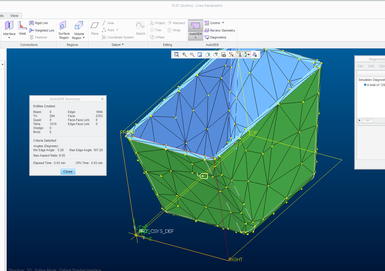

Calum, I don't know your application, but I think that this very thin metal layer is insignificant for the stress and displacement in the plastic part. If this is a stress analysis that is.
Nonetheless, if I were to do this I would put a shell on the surface of the solid, that has the properties of the coating. In this case it is two materials, but as a first guess I would create a shell material as a laminate layup with two different properties, and assign that to the shell...
In the part in the picture I have put shells on the outer surface of the solid, the solid is modeled as usual. Plastic properties fot hte part, the laminate (or metal) properties for the shell...

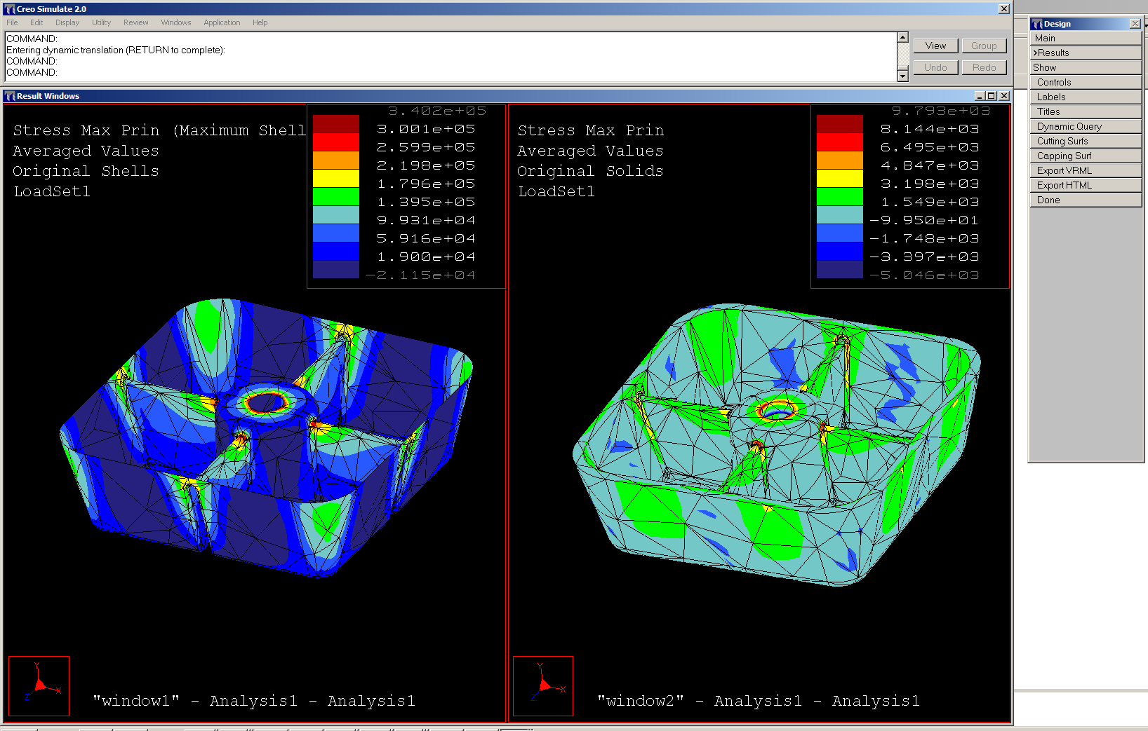

Here is a model where I created your thin metal layer as a laminate with 0.01 mm of copper and 0.005 mm of nickel. I assigned this laminate property to a shell that I defined on top of the solid surface.
Unfortunately, (correct me if I'm wrong) it is not possible to extract/view shell results separate from the results in the underlying solid elements. This can be done in Mechanica Independent Mode.
Here I created a max prin stress plot for the solid elements and for the shell elements representing the metal layer in Mechanica Independent mode. Note that the stress in the plastic (solid elements) and in the thin metal shell are considerably different, since they have a very different young's modulus.
Once again, this very thin layer does most likely not affect the stresses, strains and displacements in the much thicker plastic part. I suspect that it is sufficient to analyze just the plastic part and look at strains on the surface, and verify that the strain on the surface is less than what the metal layer can take.
