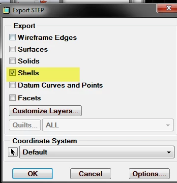

How does one create a Shell of an Assembly file?
I have to send this file to a customer, but only want them to
see the outer shell of the Assembly.
I tried creating a STEP File with Shells
[cid:image001.png@01CF5D4B.C55AB420]
Wildfire 4.0
Thank you.

You will want to do the Save As but change the file type to Shrinkwrap. This will give you a surface model of the assembly. I would try it out with a small assembly to get use to the settings before you try it out on a large assembly.
