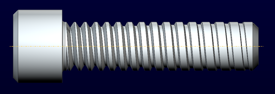

Yes, physical threads are usually helical cuts. And yes, they often fail for the silliest reasons.
Are you using the full Creo 2 version? I've attached a cap screw file if you can use it.

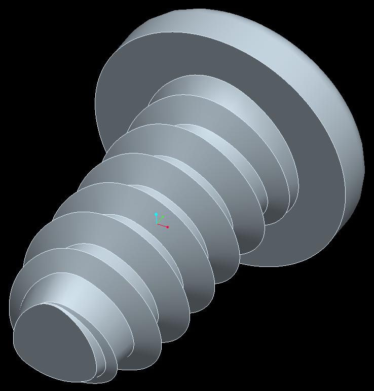

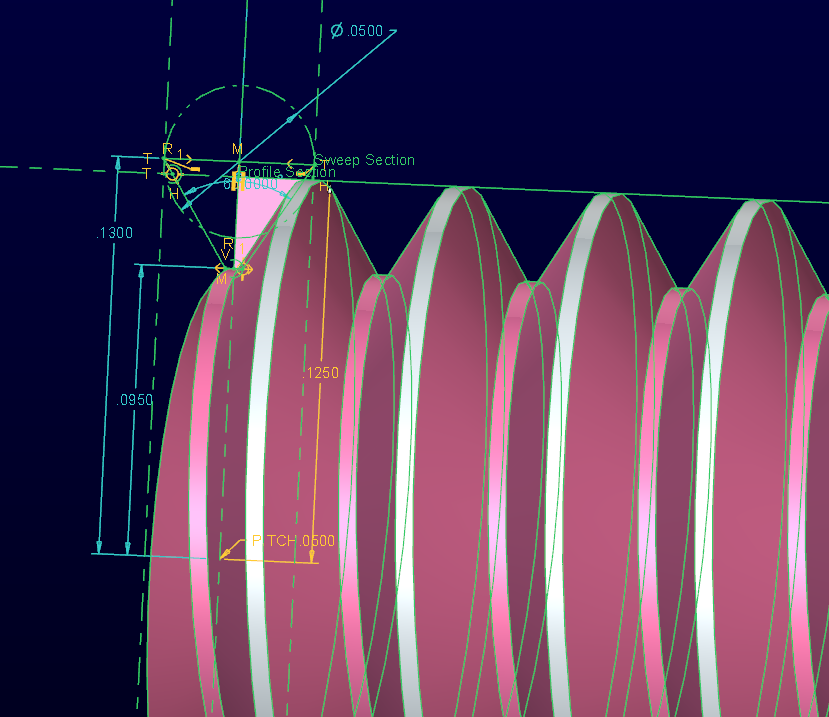

I'm glad I looked at that command again... the Helical sweep. It has some really powerful features:
June 28, 2013
What feature or option did you pick to get the threads to taper as they do in the picture above?

True... the helical sweep is much like the VSS (optional) with an added variable "pitch" option and with the limit that it is rotational about the axis.
