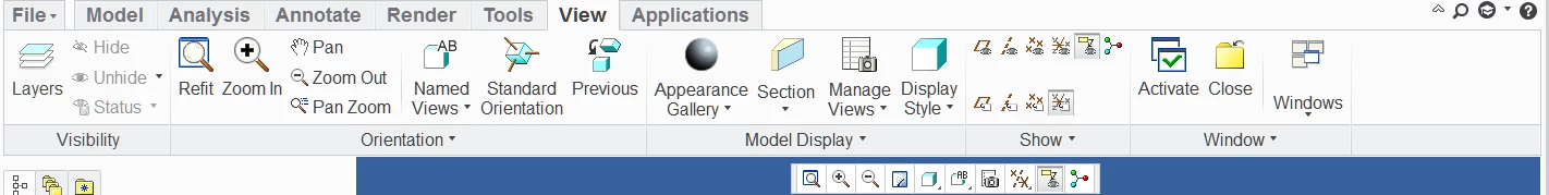

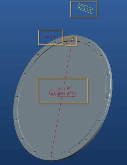

In the past, WF4, I had a datums layer and an annotations layer. Whenever I "set" a datum feature, hiding the datums layer would hide the display of the set datum. Hiding the annotations layer would hide the display of annotations like surface finish. Dimension that had geometric tolerances assigned to them displayed like any other dimension.
Bringing up the same part in Creo 2.0, (Creo 1.0 may behave the same), has numerous un-desirable behaviors.
* Set Datums, will hide via the hiding a layer as long as no geometric modifiers have been added to it. If it has a flatness, it will not hide.
* Dimensions that have Geometric tolerances assigned to them will always display.
* If you go to the Annotations tab and erase the annotations so you have a clean model to work on. You can't get the dimensions to display when you double click on a feature to modify it.
Anyone figure out how to work models with this new weird behavior?

Seems like toggling the Annotation Display on the View Tab, Show Group is the way to do it.
Showing 3D Annotation overrules layer settings I guess.
/Bjarne
davehaigh13-AquamarineAuthor
August 30, 2012

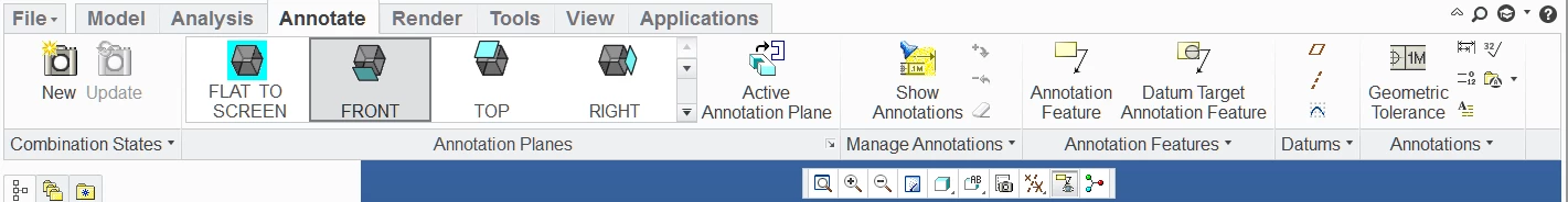

So I don't see anything on either the view tab or the annotate tab to allow me to just turn all annotations off.
Perhaps I'm blind.

August 30, 2012
Andrew is referring to the graphics window's dashboard. You have a show/hide annotation.
PTC did something weird with "Erase"... yes you have to "Delete" the annotation to have available for "show" again. Erase maintains the "showing" of the annotation in the detail tree of the drawings. Unfortunately, PTC has been blurring the lines between detailing in a drawing and annotating a model. It is a very inconsistent pool of muck when it comes to understanding what you want to show. It goes much deeper than that as well when you get into the Y14.41 3D annotation.
As for hiding the datum plane that has a datum tag assigned to them, I have already sent in many support requests and they continue to tell me this is expected behavior even though it is -very- inconsistent. Sometimes they will hide indefinitely as well once they are unhidden in a drawing. You will also find occasions where you get a fatal crash when manipulating the datum tag on the drawing. I already reported that one with the ability to reproduce the problem. Haven't heard back on this yet. But know that a fatal crash means lost work. File often!
