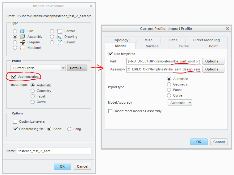

Maybe part of the answer lies in the ability to assign templates to opening STEP files. It is all "black box" to me but I suspect there is a lot of fine tuning capabilities for imports that we are missing out on without special knowledge. Accuracy control is the 1st that comes to mind.
