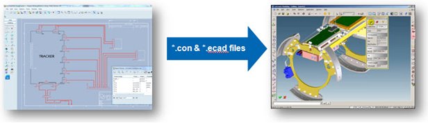

Here is how it works.  RSD requires some additional parameters to be created in order to pass down the values for the designation of the connectors thru a *.con file, and the wire list/net list for the wires/cables thru a *.ecad file.   See figure 1.
Figure 1:  Schematic info passed to 3D design thru *.con file and *.ecad file

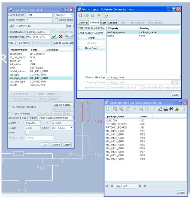

The required parameters for the designation of the connectors (*.con file) includes the following (See figure 2):
  • Name – typically the reference designator name like –P10 – (i.e. Autogenerated from –P##)
  • Package name – the corresponding CoCreate model name  (i.e. MIL_0431_GRU)
  • Do_not_export – set to false, used for criteria for exporting in reports
Figure 2: Required Connector Parameters and *.con report

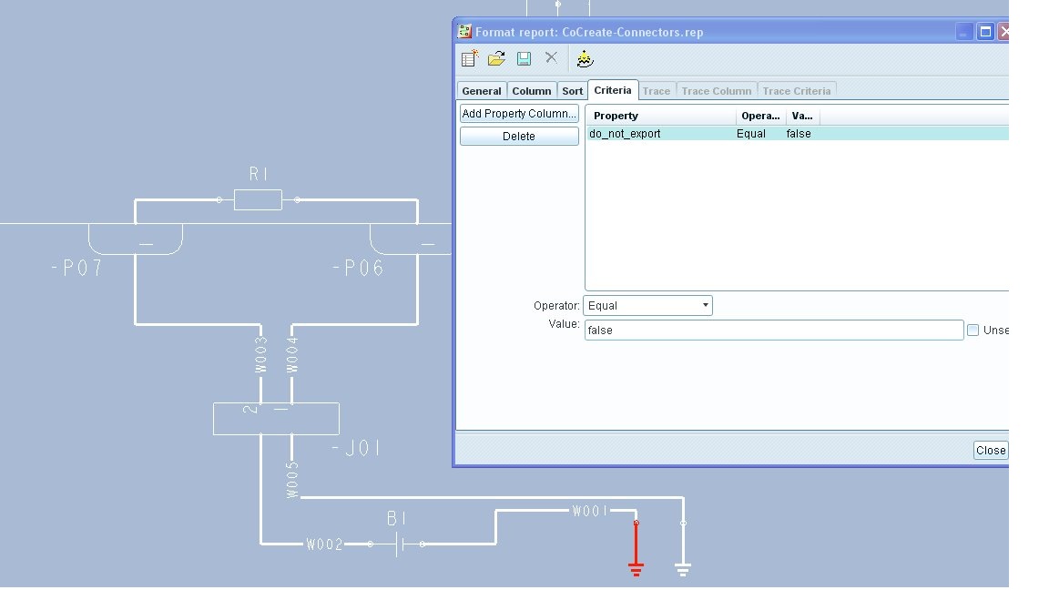

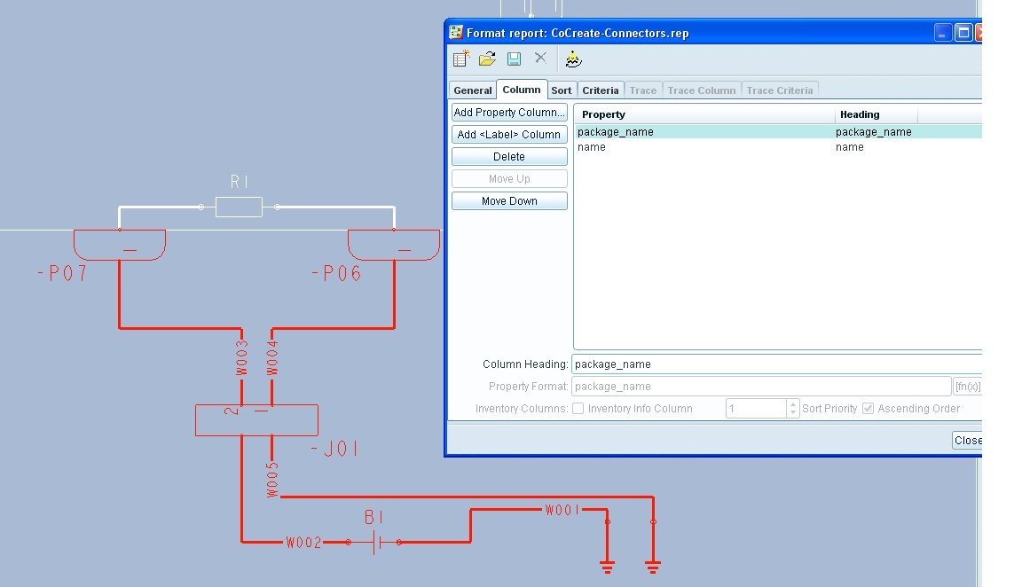

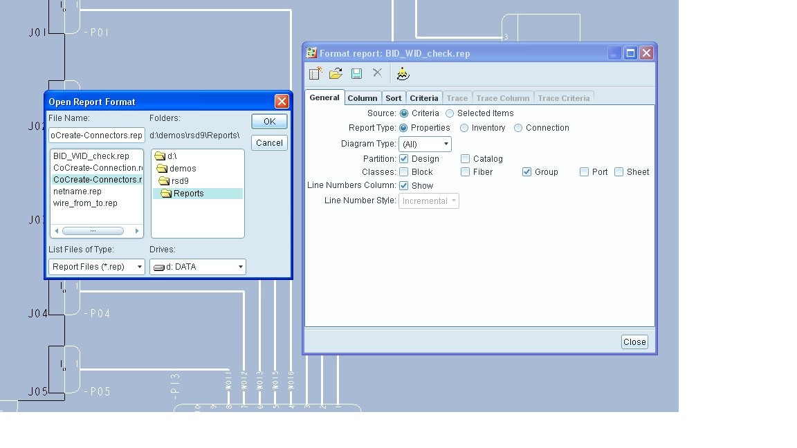

Once the required parameters have been created and assigned proper values, you are ready to run the two key reports.  The first report is set up to generate output for connector designation.  Typically, you’ll need to set this report up once and save it to a file so it can be re-used.  Open this report or create a new report.  The report needs to have column tab set to show package name and name, and have the criteria tab set to “do_not_export” equal to “false”.  If needed, a PTC RSD specialist has an example report “CoCreate-Connectors.rep” saved that can be sent to you with proper report settings for reference.  See figure 4.
Figure 4: Setting Up Connector Report (*.con file)

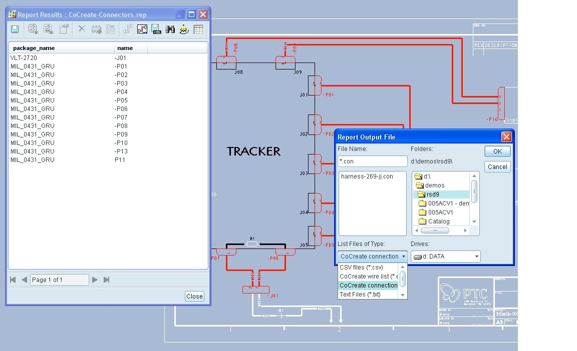

Next, select the key connectors for your harness, and run the report.  From the report results, select the save button in upper left corner, and save the report as a CoCreate connection (*.con file).  This is one of two key final output files required for CoCreate.   See Figure 5.  Let’s look at the second output required now.
Figure 5:  Save report as a *.con file for connector designation

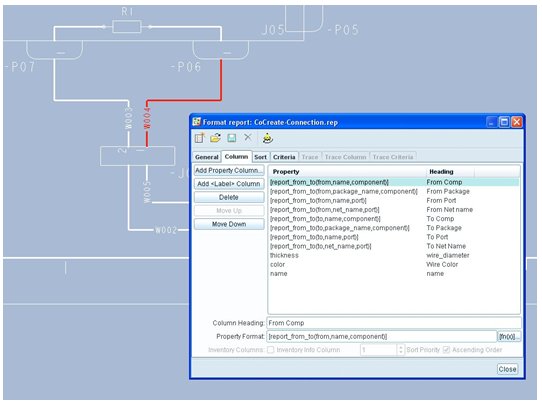

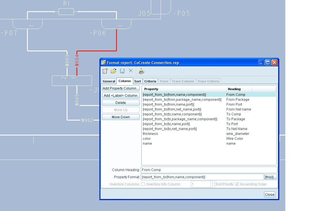

The second report is set up to generate output for wire list/net list.  Similarly to the first report, you’ll need to set this report up once and save it to a file so it can be re-used.   Open this report or create a new report.  The report needs to have column tab set to show from/to information as show in the figure 6 below.  Also, the criteria tab set to “do_not_export” equal to “false.  If needed, PTC RSD specialists have an example report “CoCreate-Connections.rep” saved that can be sent to you with proper report settings. See figure 6.
Figure 6: Setting Up Wire list/Net list Report (*.ecad file)

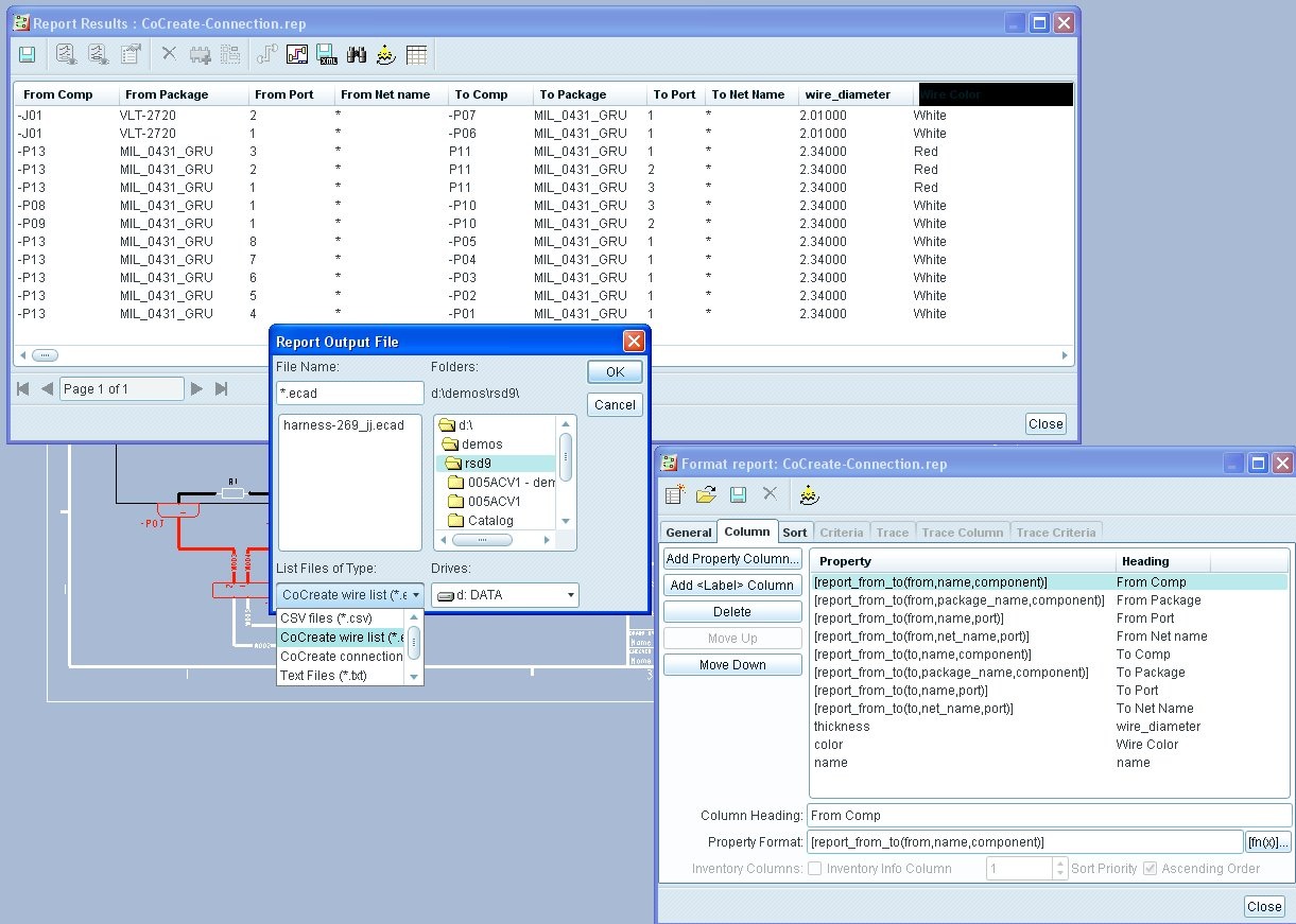

Next, select the key connectors, wires, cables for your harness, and run the report.  From the report results, select the save button in upper left corner, and save the report as a CoCreate connection (*.ecad file).  This is second output files required for CoCreate.   See Figure 7.
Figure 7: Save report as a *.ecad file for wire list/net list

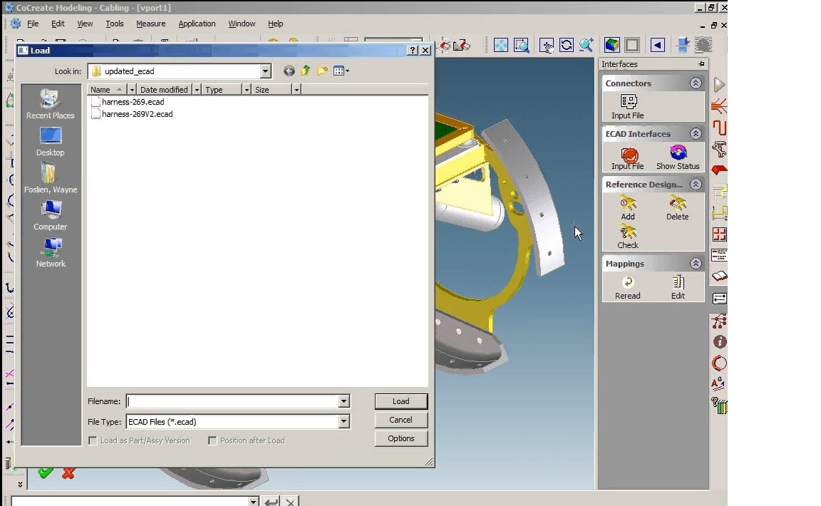

6)                  Begin the auto routing of your connector by loading the *.ecad file for the wire list/net list.  See Figure 8.

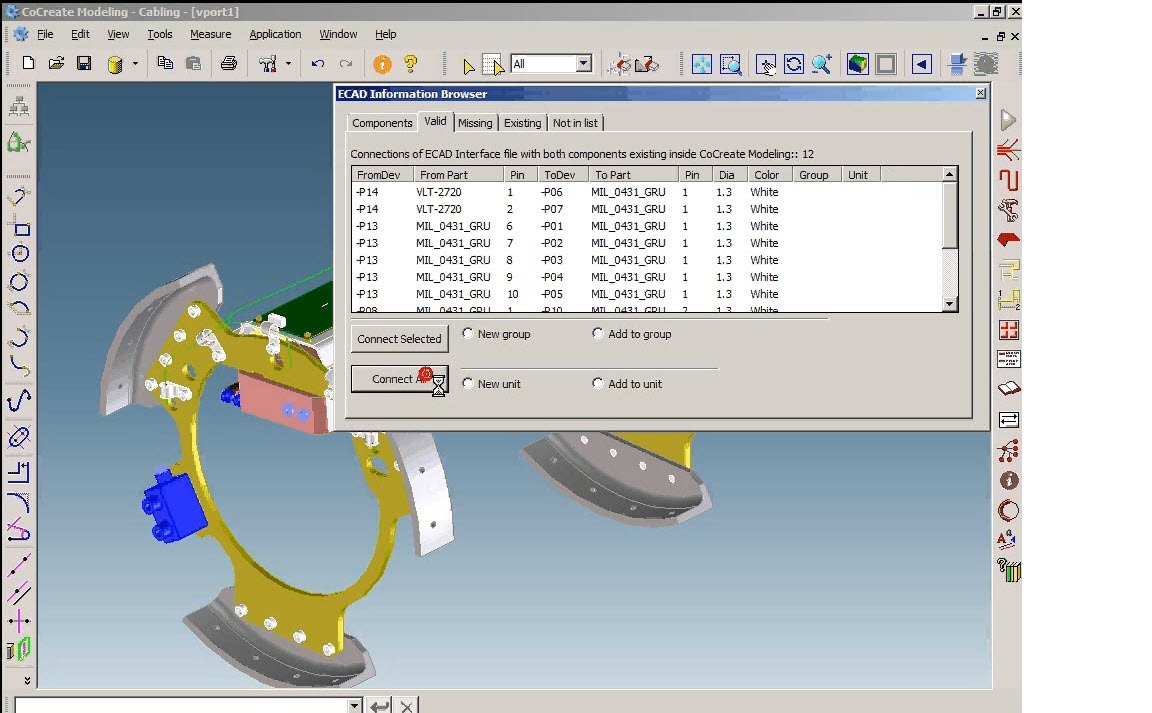

😎                  Go to the next tab – Valid, and connect all the valid connections of wires/cables.  See Figure 9.
9)                  Now route the wires thru the channel using channel routing.

Figure 8:  Reading input file *.ecad from RSD

Figure 9: Auto routing all valid connections
