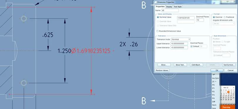

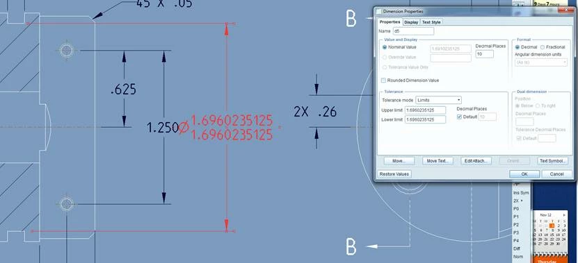

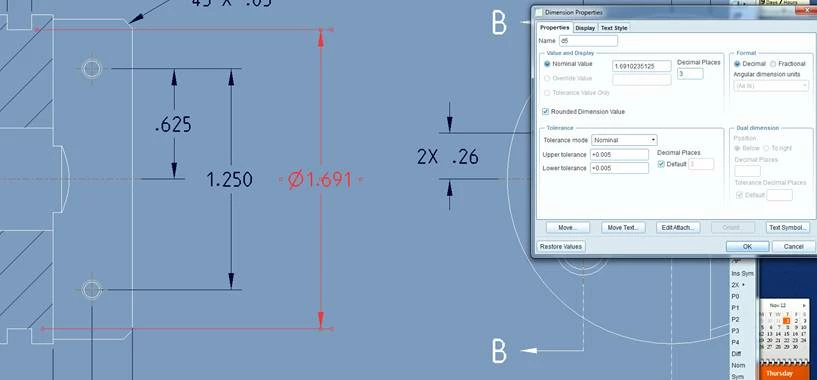

I've played around a bit in Creo 2, I'm not sure I would call what I'm seeing an enhancement. We work on some highly accurate parts, it not uncommon to use 4 digits in inches and 3 digits in millimeters.

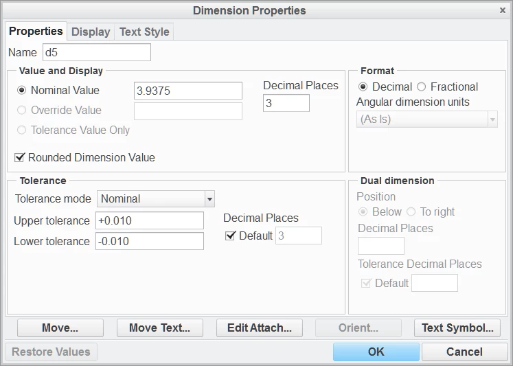

I entered 3.9375 in the sketcher. The sketcher shows 3.938. Finish the feature and measure, it shows 3.9375. Double click on the feature to show the dimension and it shows 3.938. double click on the number to edit it and it shows 3.9375. The drawing shows 3.938. Edit properties on the dimension and it shows this.
[cid:image002.png@01CDB6A5.678682A0]
This is different behavior than in Wildfire 4.
What config options control this behavior?
* What settings make it like I see out of the box in Creo 2
* What settings restore it to traditional ProE behavior?
Why would I want the new behavior?

No, I tried the default settings, strong and weak dimensions and the
model can still be different than the shown dimensions. But with the
settings as suggested to get back to previous functionality it FIXES
this new MIS-direction.
* Set config options to yes
o round_displayed_dim_values
o sketcher_strngthn_to_def_dec_pl

The point is, even if you enter a strong dimension, say it's 3&15/16" or 3.9375". You can show it on the drawing as 3.94" without changing the model. That is a fundamental change from how ProE has always worked in the past.
So the issue is not just limited to weak dimensions.
Regardless of whether you decide to use rounded dimensions or not, I think you need to know about this change. For our companies, I don't imagine we will be using rounded dimensions.
