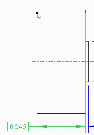

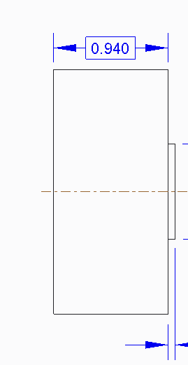

I've been searching and have not found an answer so I'm creating a new post.
I'm working on a drawing in Creo 2.0. I use Show Model Annotations to include a dimension which then appears on one side of the part with correct offset gaps between the witness lines and the part geometry.
Then I drag it to the other side to fit into the overall dimensioning plan better and the witness lines don't snap to offset properly to the new side. They remain connected to the first side and I need to drag them individually.
Is there any way to change how this works? If not, does anyone know if there is already a PI created to change this or if this will be fixed in 3.0?
Best answer by dschenken
The gap is not automatically fixed for shown dimensions.
It is fixed in the output when the drawing is plotted/printed if the interface_quality config setting is set to 3.

Reassociate the dimension to the other end points of the vertical lines. All you have dragged is the dimension text, the extension line associativity is still to the original end points of the vertical lines.
lroose1-VisitorAuthor
November 24, 2014
I'm not sure what you mean by reassociate. I haven't seen that command/action listed anywhere. Do you mean Edit Attachment or delete/recreate it on the other side?
I just discovered that when I create the dimension using the Dimension command, it behaves the way I'd like it to, i.e. it automatically maintains the proper gap as I drag and place the dimension on the other side.
I was hoping that a dimension brought in using Show Model Annotations would do this as well but it seems that it doesn't.
dschenken1-VisitorAnswer
November 24, 2014
